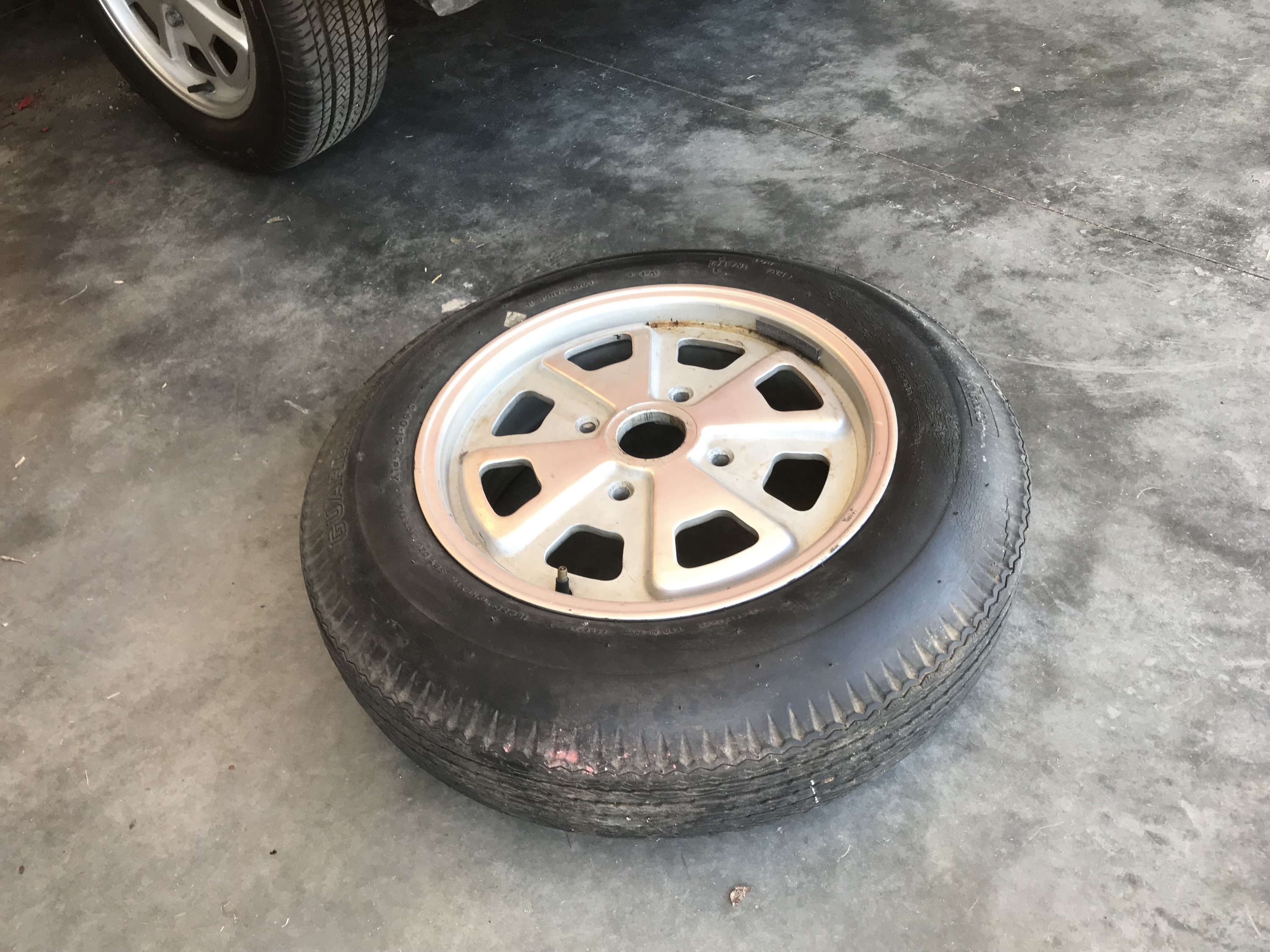

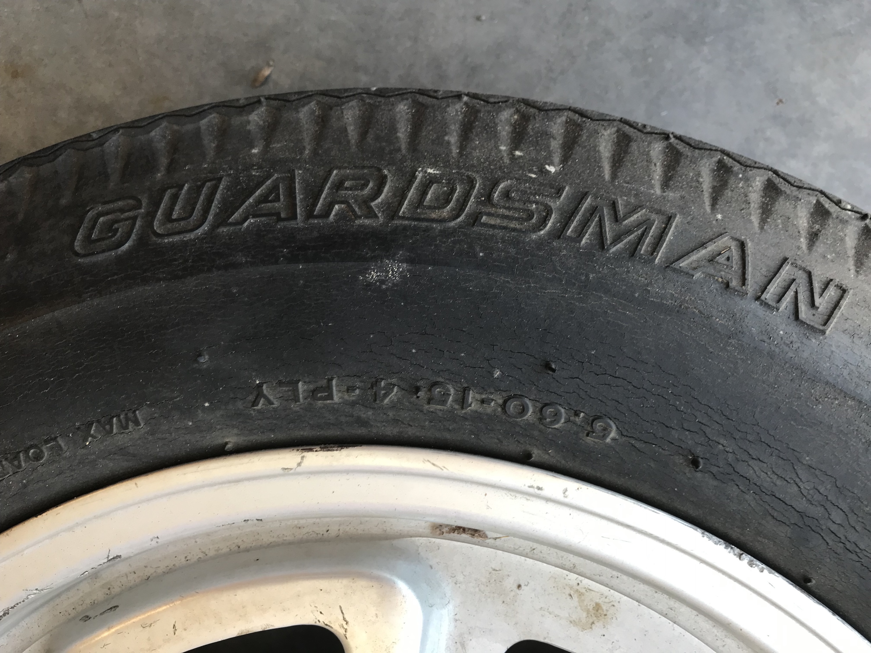

My project car came with a genuine Sears Guardsman bias ply, 6.60-15. No date code but probably late 70s or early 80s. Maybe 40 years old when I got it?
