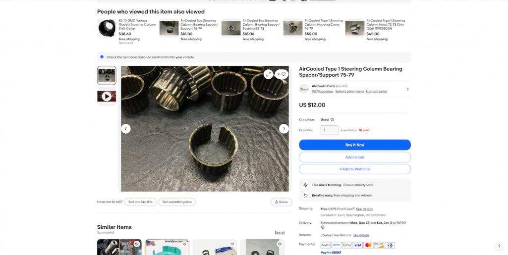

The ones with the corrugated sleeve are even better. Not sure who made them or if they're still available.
SirAndy
post Dec 23 2025, 06:49 PM
Resident German
Posts: 42,384
Joined: 21-January 03
From: Oakland, Kalifornia
Member No.: 179
QUOTE(SirAndy @ Dec 23 2025, 04:45 PM) *
Looks like this

QUOTE(Osnabruck914 @ Dec 23 2025, 06:06 PM) *
I did not run into anything like that when I shopped around for the part. Does look like it would be extra effective with the corrugations.
They may have been a VW part. Got mine some 20+ years ago, still works like new.
