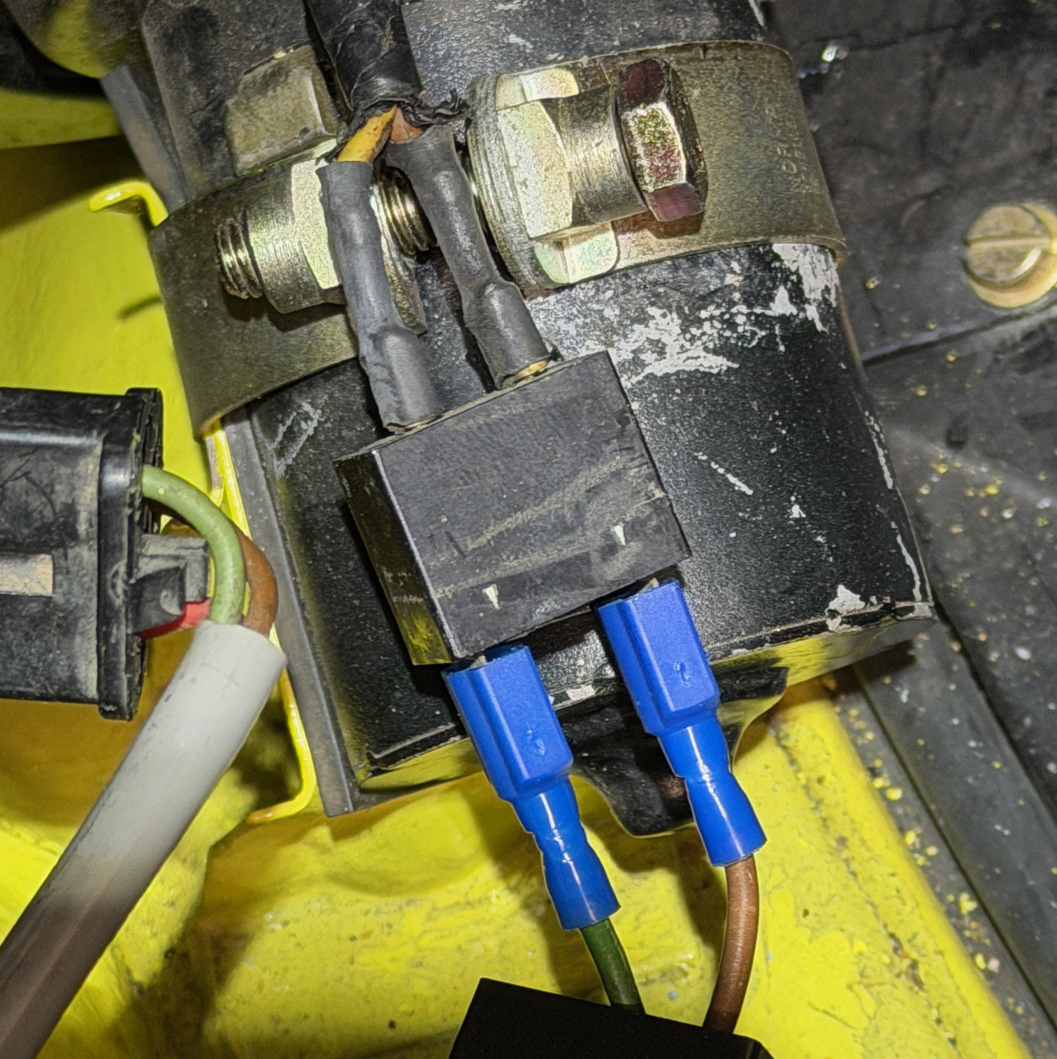

I took out my heater blower for access to the area underneath it, and while it is out I thought to replace these rather old, yellowed and slightly corroded connnectors.
The couplings came off the motor easily enough, but I was not able to easily remove the wires from the couplings - I had originally thought they were just another spade connector that should come off with a little coaxing, but they look somewhat different... Is there something special about these guys, were they not designed to be removed?

Those are two, of what I call 'long blade' male, 6mm, terminals, that mate with two female 6mm terminals. They mate in a double box housing and all terminals are removable by releasing the tang.
I dont recall if the terminals on the chassis harness (in your photo) are male or female, inspection should clarify. They are opposite gender from the mating terminals on the fan.

What's also interesting is that I have this extra piece between the fan and the cable harness.
I'm assuming it is the "suppressor" (RF noise) for "vehicles equipped with a radio" talked about in the install instructions...?
The instructions say to be careful to respect the polarity - I assume that the motor is a simple DC brush motor whose speed is varied by the input voltage and reversing the polarity would make the fan run backwards... Did I get that right?

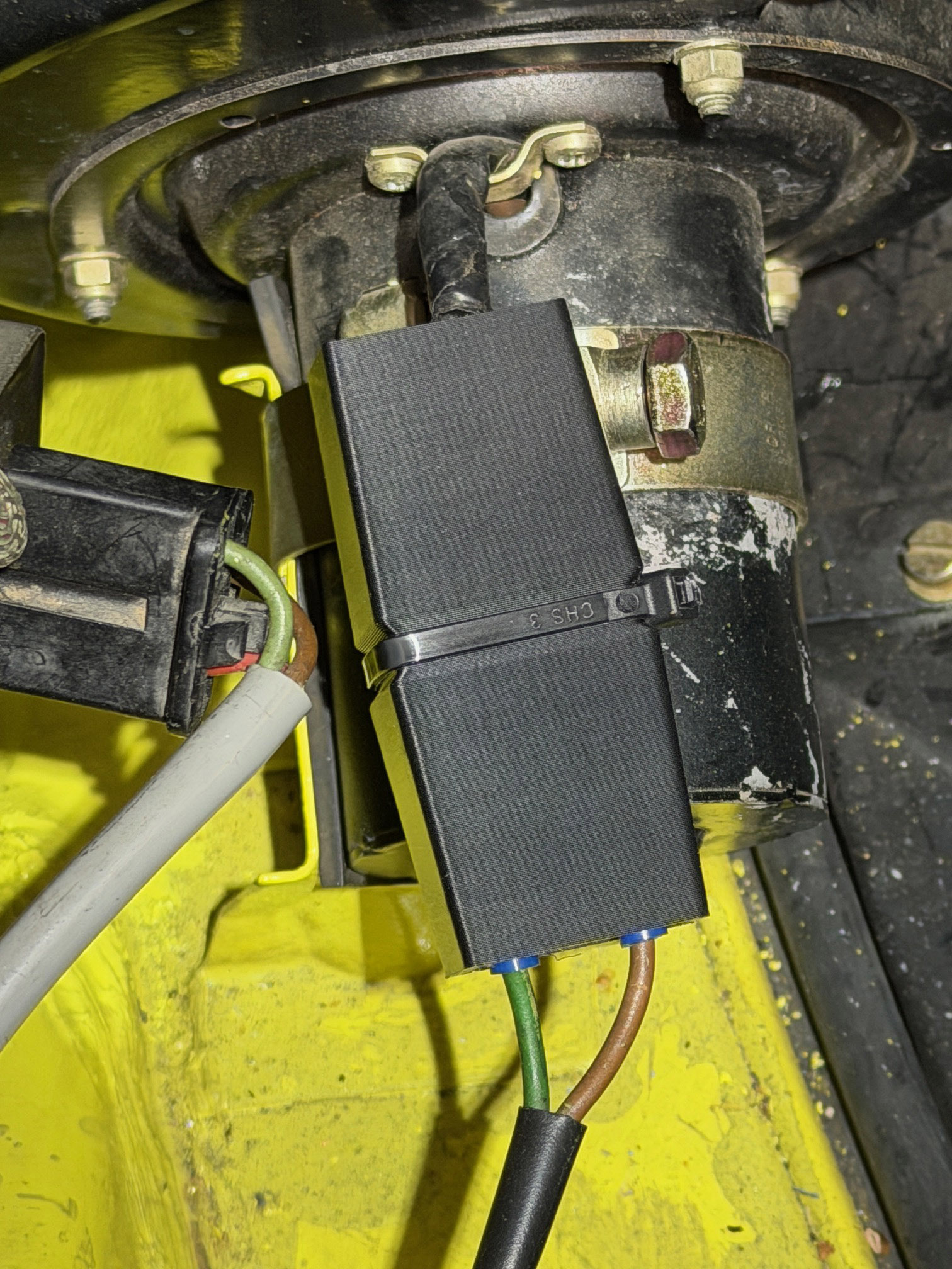

In the end I clipped off the original long spade connectors which were corroded and put on a pair of insulated male spade crimp-ons.
I 3DP'd a small cover for it as the manual said there was one. Not sure yet if that's definitive yet.
