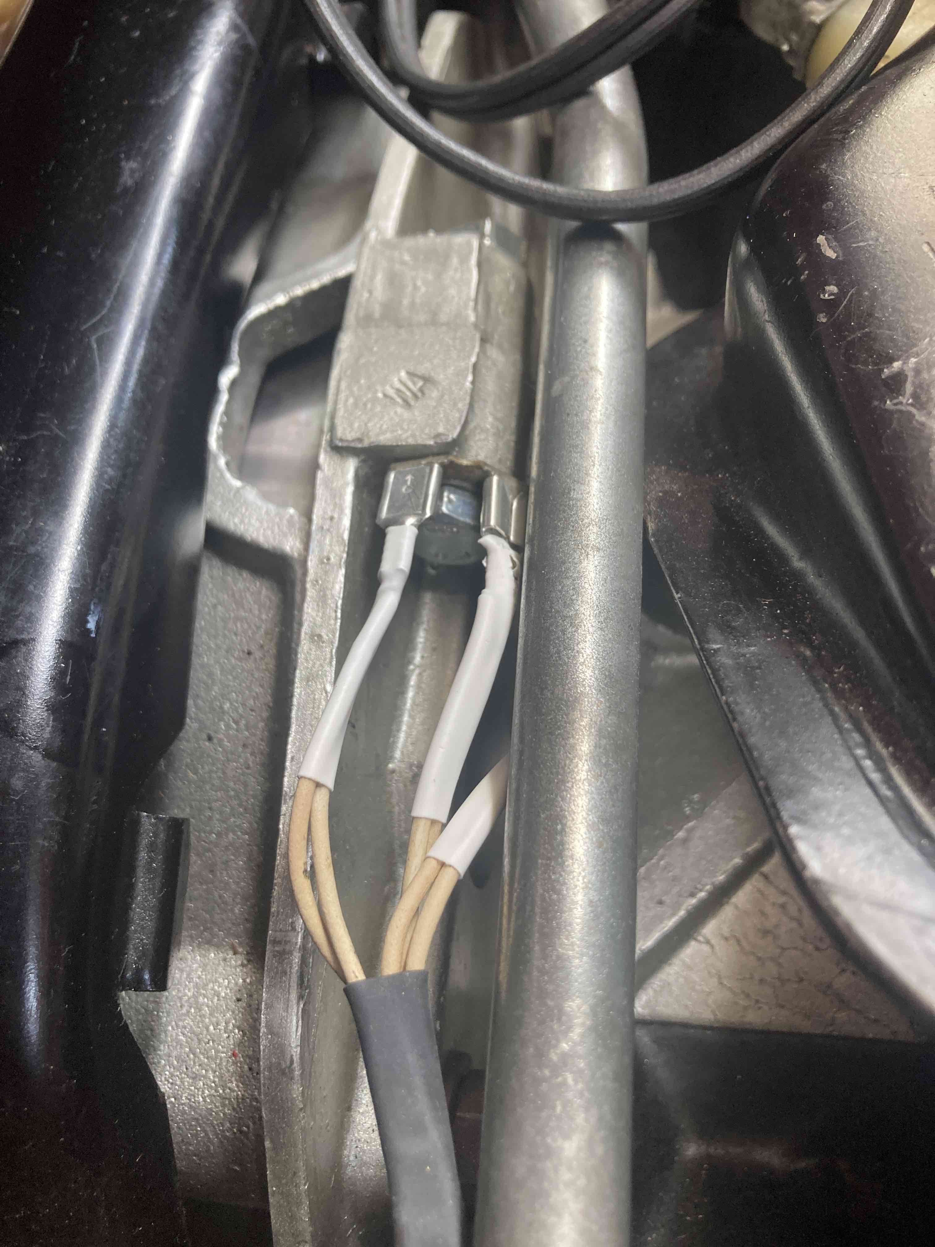

Would like some help… Three sets twin white wires 74 2.0 D-Jet harness I believe are the ground wires.Does anyone have a picture of how this works TIA Dennis
post Dec 14 2025, 06:20 PM
Posts: 9,138
They connect to a trispade terminal which mounts to the upper engine case, rearmost case bolt.

QUOTE(JeffBowlsby @ Dec 14 2025, 04:20 PM) *
Thank you was looking for something like that but seems to be missing… I’ll make it work

Hers a photo showing where the grounds are for my 1976 D-Jet @Flyinlow
