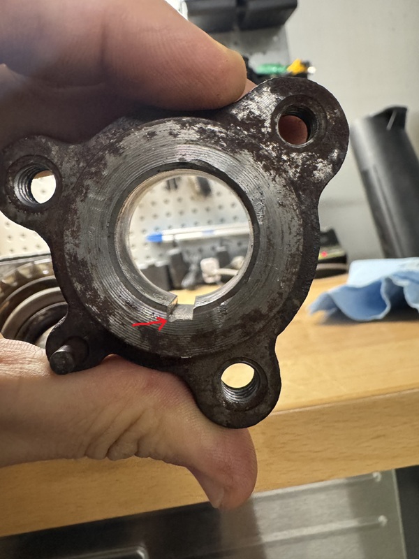

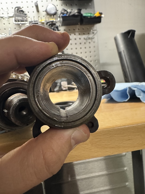

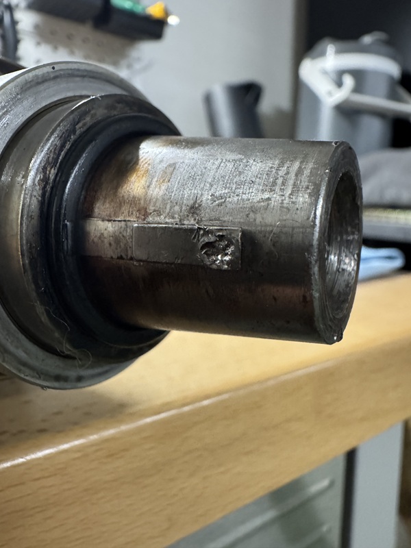

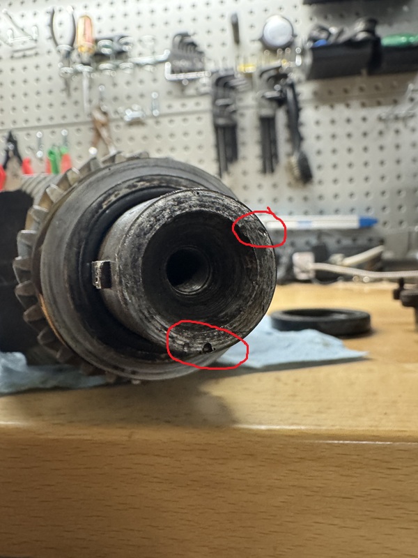

Hello all,
I am making slow progress on the 1.8L 1975 Engine Rebuild.
So far I have ordered new 96MM pistons and cylinders, valve springs, lifters, push rod tubes, engine seal kit and new front and rear seals.
While taking off the fan hub, I noticed a slight bend in the front part of the groove for the woodruff key and not sure if this is cause for concern? Should I consider replacing this fan hub assembly or is that not enough cause for concern? I used some gear pullers so not sure if that was my doing or not. (IMG:style_emoticons/default/dry.gif)
Also, a picture of the condition of the crankshaft end with a slight ding circled in red and the wodruff key, I am planning on replacing the key of course but not sure if someone used a tool to seat it in place? No cause for concern on the crankshaft correct?

From what I can see, just a bit of cleanup (file) to remove the burrs and a new keyway are in order

Looks like some DAPO hammer peened the key in order to keep it in place? (IMG:style_emoticons/default/huh.gif) (IMG:style_emoticons/default/ar15.gif)
