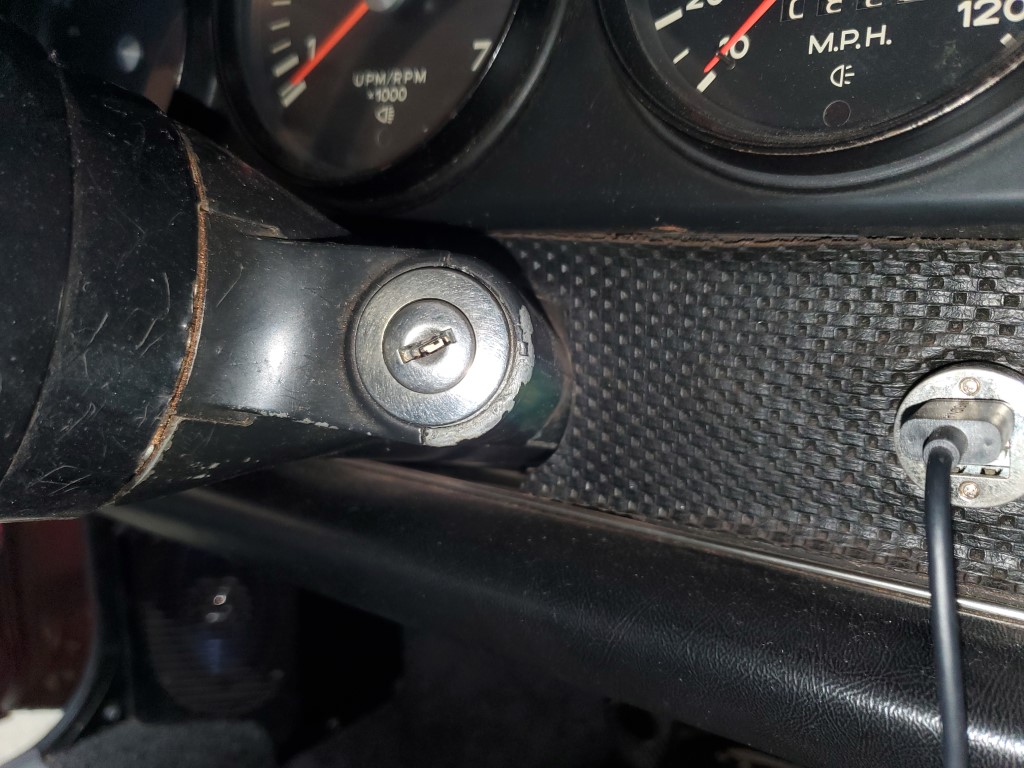

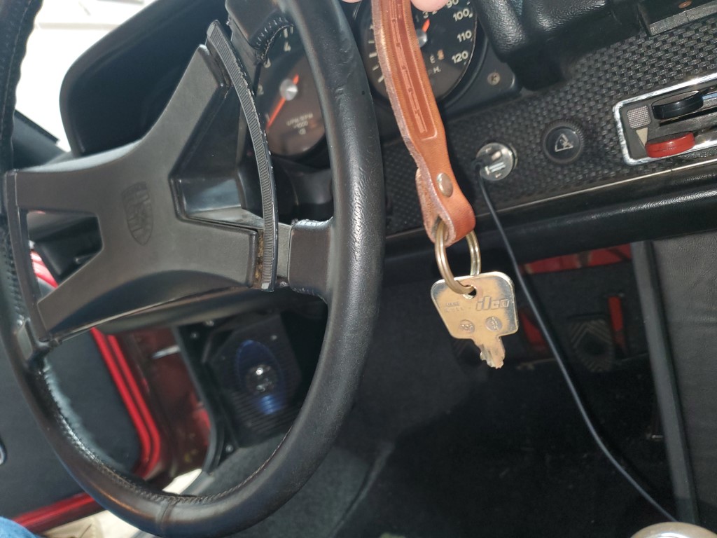

While turning into a parking space I felt a tug on my hand. My finger snagged my key chain and mortally bent the key. Being the only key I have I'm down to starting my car with a pair of pliers.
Who can re-cut 914 keys? I tried once locally an no one would do it.

Well, you're probably going to have to remove the ignition switch to get the rest of the key out anyway... Once you have the broken piece to copy from, a decent key-maker person might be able to clamp it in their key-copy machine. Key blanks seem to be easily available.

You may be able to dig out the broken part with two sharp picks. Any locksmith should be able to cut a key. Call around locally. Its a common VW blank.Curt can do it too. Do you have a spare to copy? If not pull the rear trunk lock and have a key made to it. Much easier than pulling the ignition lock.

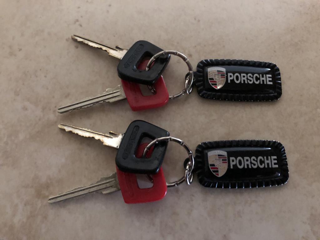

I had these made at the local locksmith. IIRC, I bought the blanks on eBay.

Thanks. Bought 3 blanks from ebay.
I took one to a local dude and he said he couldn't do it and when I pressed him about it he cut the key and really f-ed it up. I think he was pissed that he didn't sell me a key.
