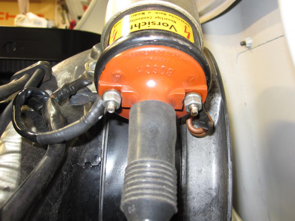

1 Yes
2 Black/blue w ring goes to coil
3 Yes, you need a short brown wire large (8mm) ring one end and small (5mm?) other
end. Extends from coil to coil mount stud.
The other coil mount stud gets a 8mm ring that is included in harness.
4 Included in harness 3 gang plug on CD

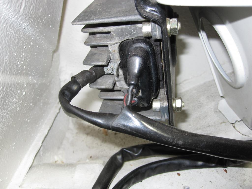

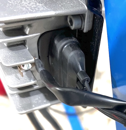

rgalla9146
post Dec 6 2025, 02:54 PM
Posts: 4,885
Joined: 23-November 05
From: Paramus NJ
Member No.: 5,176
Coil

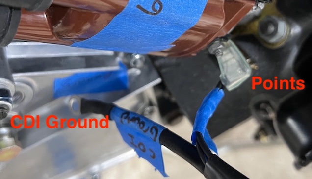

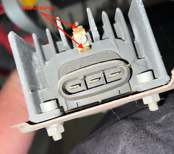

2. I probably didn't do a good job describing this. A photo will help.
The female spade connector in my diagram is labeled:
From: Points (black-blue)
The disconnected ring terminal is labeled:
From: CDI_Ground, To: CDI_GND (unspecified color)
This ring terminal on the left is meant to reach to the CDI and I need to utilize the terminal retaining bolt? I don't see where else it would go. Maybe it's mislabeled?
In your photo Rory, I only see a single wire on that CDI ground terminal. Which is what I have there now. The three pin female plug with a branch female spade to the ground terminal.
