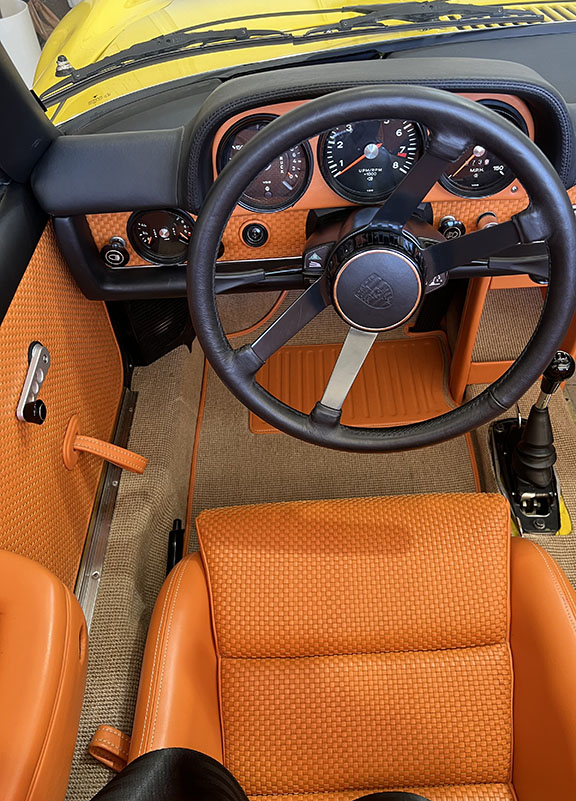

Interesting, it looks like your speedo is on the left, so I'm guessing your combo gauge is on the right?
It was not unheard of back in the day for Six conversion cars to run a 911 combo gauge (oil temp/press) in place of the 914 one, and the 914 one added to the center console so you have the warning lights and fuel gauge there.
Cool idea to have the smallest 911 gauge in the dash like that.
--DD

Ready to go on the drive with my local 914world buds in an hour. We are going on the post-thanksgiving run to malibu, I will ck it out when we get up there. It will be plenty warm then.
A picture of all the gauges for reference @Dave Darling
Best Bob b
