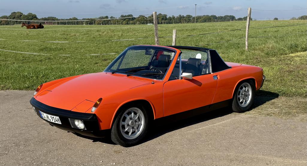

Thank you guys for your feedback. It seems like the oil consumption is in spec but still a little high. As this have been the first 1.000 Km for the new engine, I give the whole thing a little time to settle in while monitoring carefully.
By the way: it`s a first hand 1973 Porsche 914 that I have overhauled over the last years. I couldn`t do it without having such a good forum and many enthusiasts like you.
