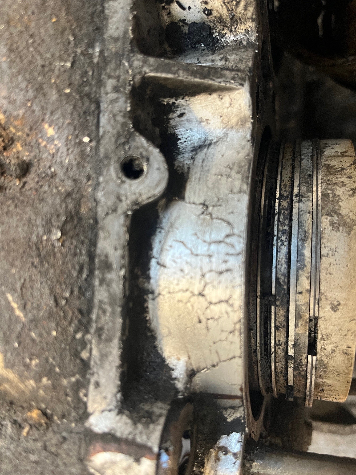

Hello, i tore down my 1970 1.7L to rebuild it and on cleaning the grease off the top of my crankcase, i saw the attached which made me nervous. Attached Image . These 'cracks' are located essentially all over the top of the crackcase but seem more pronounced right over the cylinder/piston entry points, and a bit more concentrated on the drivers side. Are these cause for concern or just casting marks? I can sand an area down to see how deep they go but figured i would ask first. (The engine had been running well but smoking and leaking hence the rebuild).

Typical feature of the case casting process.
post Nov 25 2025, 06:51 PM
Posts: 20,587
Many threads on pelican about casting marks on engines and transmissions masquerading as cracks. You are good.

QUOTE(Tking327 @ Nov 25 2025, 04:55 PM) *
all cases have thes casting marks. some are worse than others. You should be good unless you see them in the areas where the case is machined, such as the crankshaft or cam cradles.

Normal.
Now, that surface you exposed, where the base of the jugs sit, is one of the more common areas to have machined flat. That surface sags with age alone.
Sir Raby states it's almost never flat.
You have to pull the head studs and find a machine shop that is willing to machine it flat.
As it is lower than the case casting around it some machine shops don't have the equipment or knowledge to correctly mill that.

The easy test here is to determine if the marks are raised above the surface which indicates a casting mark. These are easy to clean with a little solvent. On the other hand, if after wiping, there is still a trace of dirt below the surface, then a crack may be suspected.

Super helpful these replies make sense. Thanks for the comment about the sagging as well. The machinist has a lot of experience in type 4 rebuilds so will ask him to pay attention to that. I was able to remove all but one of the long head studs with a little warming, but that last one is really stuck!
