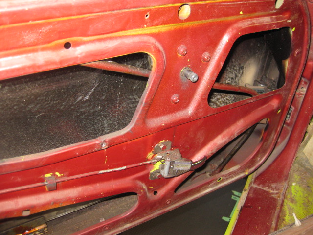

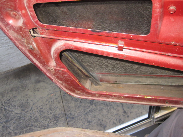

So, to clarify, even if the 73 door doesn't use the scissor mechanism the glass is the same? Sorry if that's a silly question. I haven't touched the innards of the doors yet and so know nothing at this point. I dug up a couple of pics of the inside of the doors for reference.
