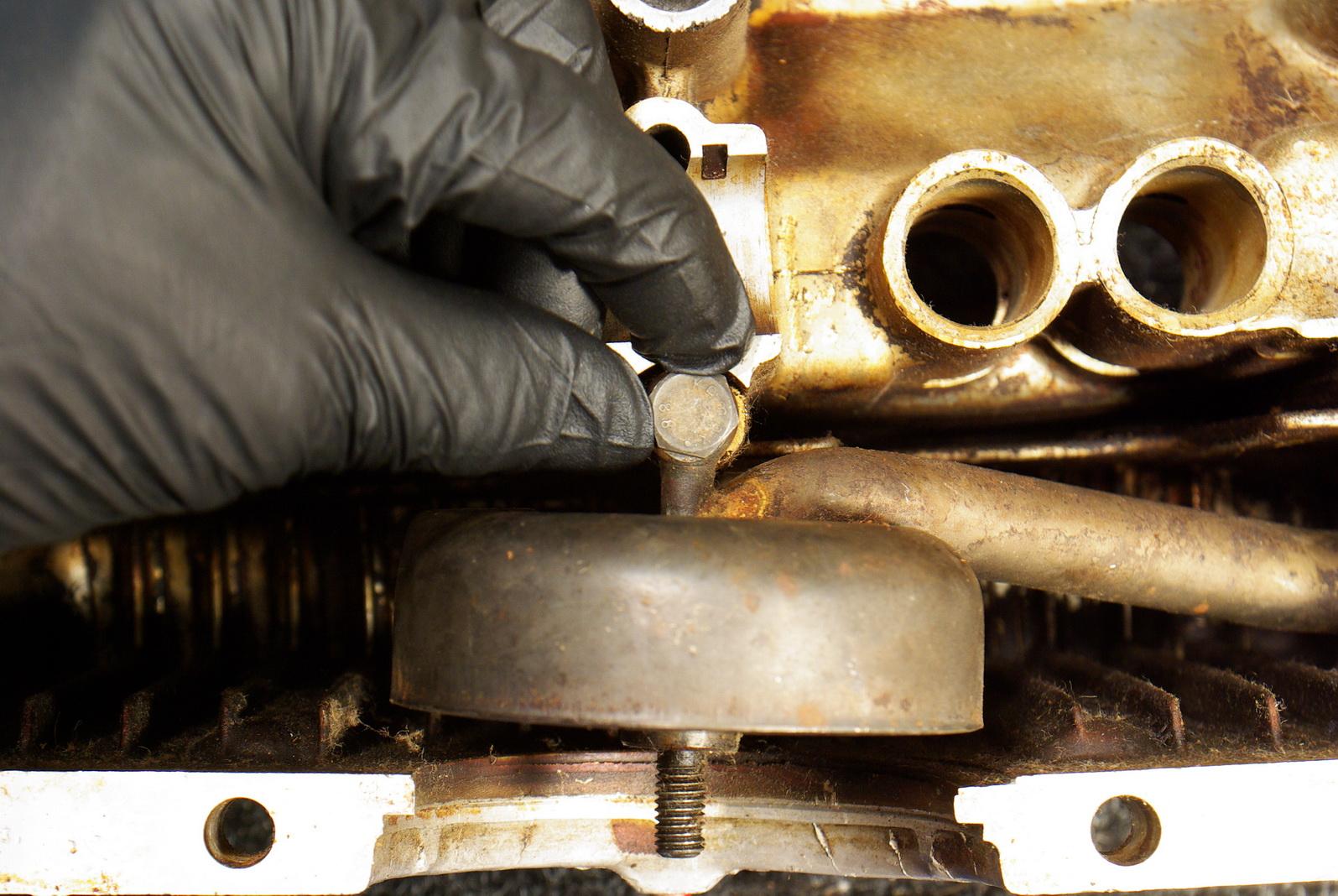

Sorry to hear about your motor. As you know, it's a nasty feature of the type iv motor.
It's not a stud that pulls out (see photo). It's a through bolt that goes into a fairly weak boss. When it fails, often your case pretty much becomes scrap metal. It's normally a big chunk or crack in the boss that goes into the camshaft journal. Sometimes it can be repaired, but often it means finding another case.

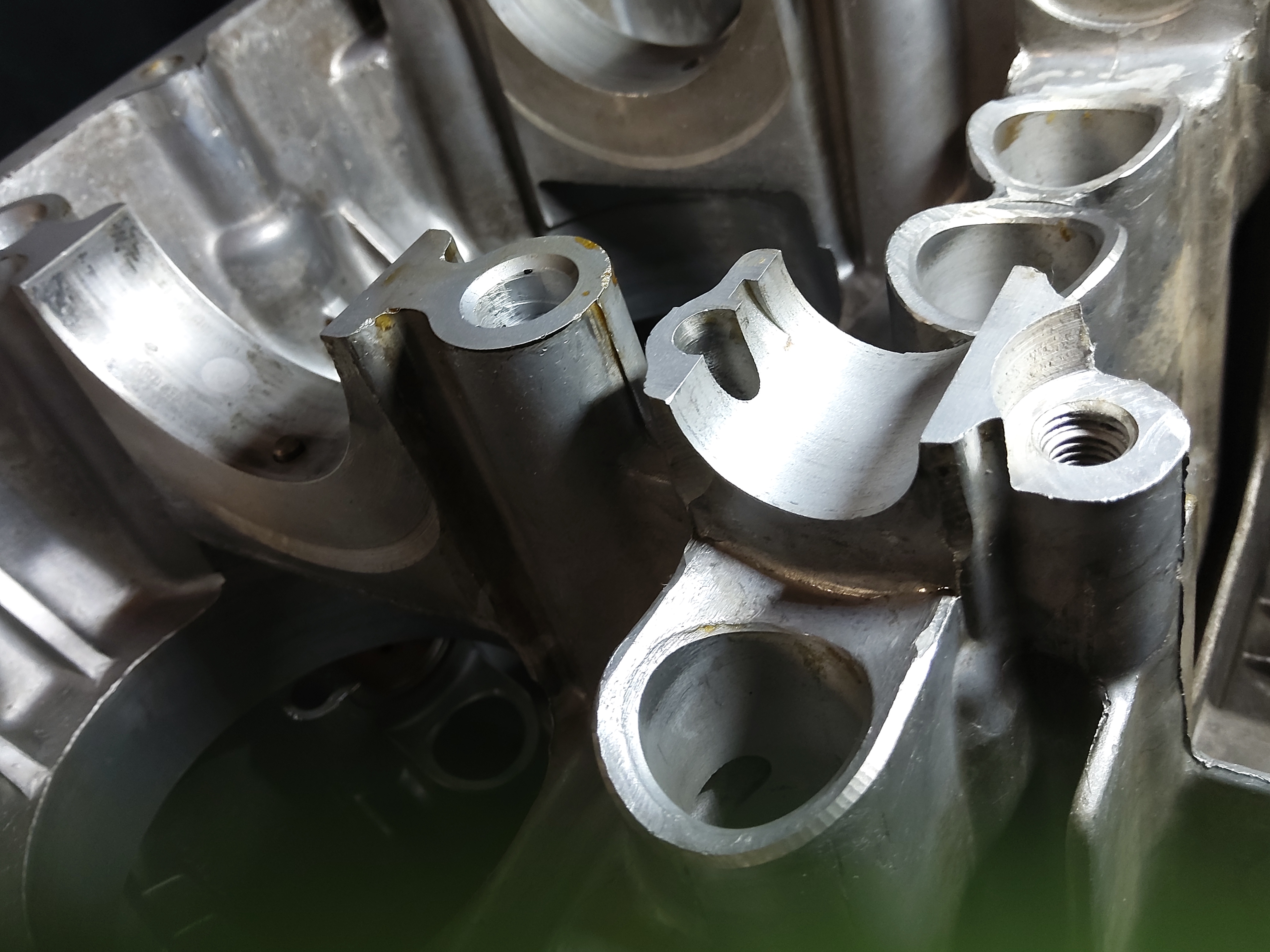

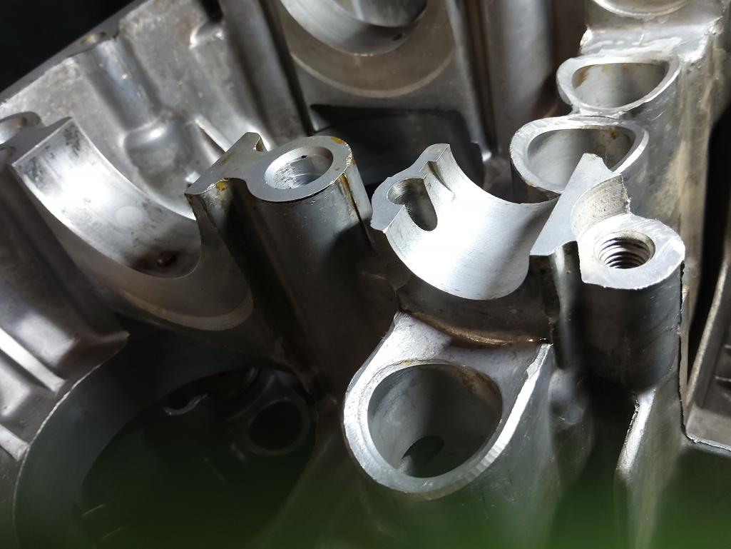

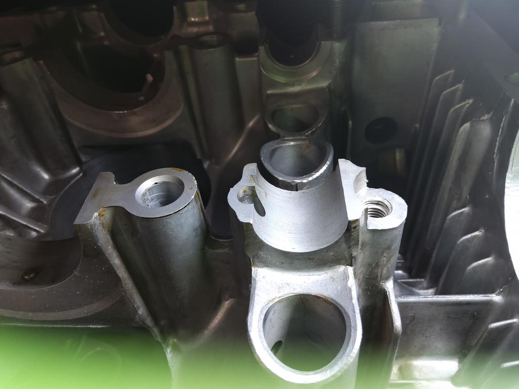

The boss is on the left/driver's side of the motor.
Here are some photos that show how close to the camshaft bearing the boss for the oil pickup comes. The bolt that goes through the "eye" on the pickup works as a lever to apply sideways pressure on the bolt when one tightens the fastener on the strainer cover.
Jack Standz
post Nov 22 2025, 09:34 PM
Posts: 594
Joined: 15-November 19
Member No.: 23,644
2nd photo
