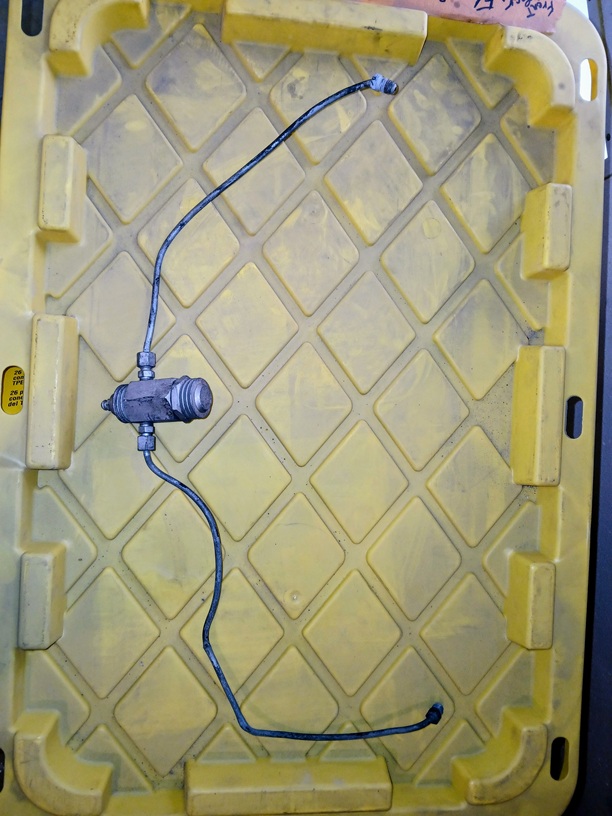

> Anyone know what this brake system part is?

This was on my 6 in the front just after the master cylinder. The car was raced and AX'ed so it may have been something to do with that. I have never seen this Rubgoldberg part before. Anyone have a history on this thing?

non-stock

safety braker,, gives a metered flow to brakes ..some people did left fronts because of shorter line to prevent premature skidding and or both fronts or rears ...
post Nov 22 2025, 09:55 AM
Posts: 5,187
Maybe some kink of proportional valve? Where was it in the system?

QUOTE(sixnotfour @ Nov 22 2025, 09:54 AM) *
Is it worth anything or should I toss it? Who makes them? I am not using it. I am installing stock lines.
