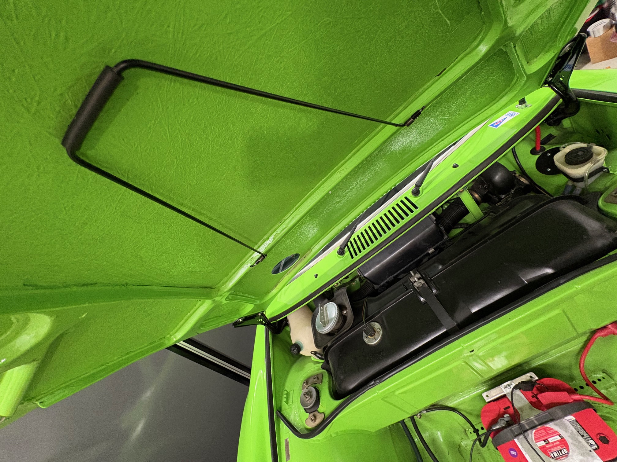

The GT hood prop on my newly restored GT clone does not retract up against the inside of the hood. The springs are too weak.
Before I attempt to remedy this myself, I was wondering if anyone has experienced this and fixed it.
Any suggestions appreciated.

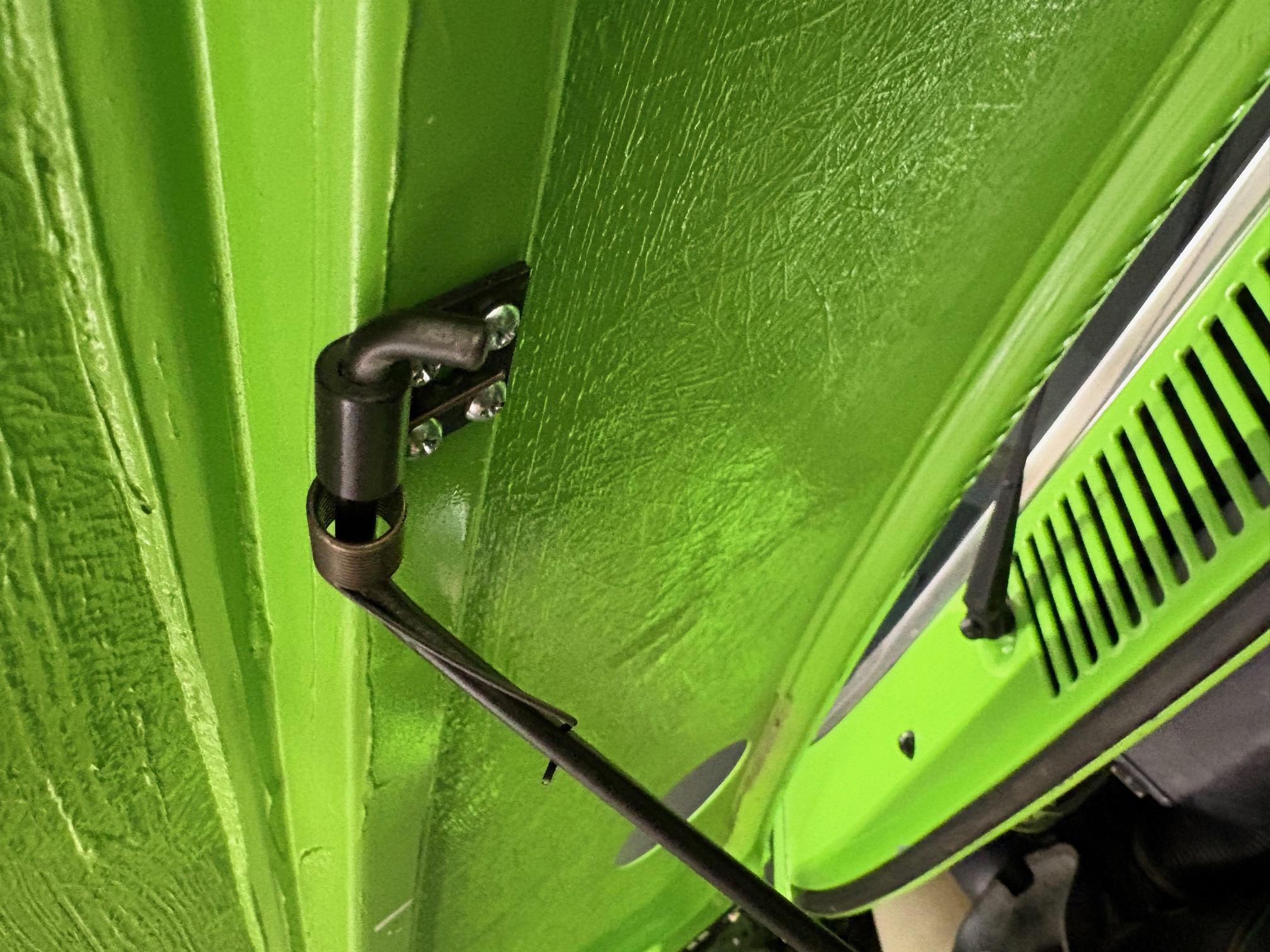

I had the same issue Tom. Wound the spring one revolution tighter but had to add a little clamp to keep it from slipping over the bend. Works well now.

We use a single prop (not the GT version) without springs on the fiberglass hood on our 914 that clips into a holder. That is an option, but otherwise probably just give the spring another turn?

Is the fiberglass reinforcement strong enough to resist a stronger spring ?
I think mine is too weak to even attach the brackets. (IMG:style_emoticons/default/sad.gif)

Mine works fine. Possibly PMB changed the mounting tab, mine is probably older than yours? The way I fitted it (hinge forward) gives the spring an extra half turn compared to yours - possibly making all the difference.
