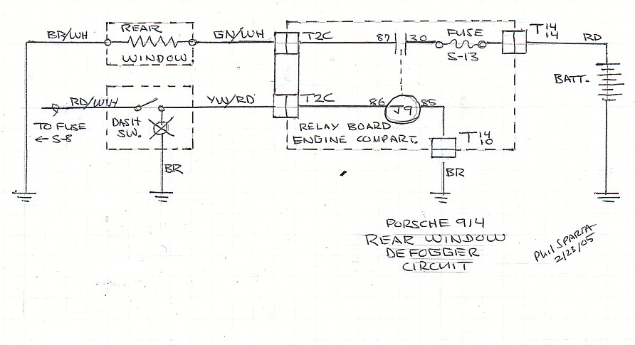

Just need the wires color that runs from the switch to the rear relay board(
and the wire from the fuse panel to the switch.

post Nov 10 2025, 05:44 PM
Posts: 9,938
Found this diagram on a 2005 Aaron Cox post: (IMG:style_emoticons/default/smile.gif)
@94teener
