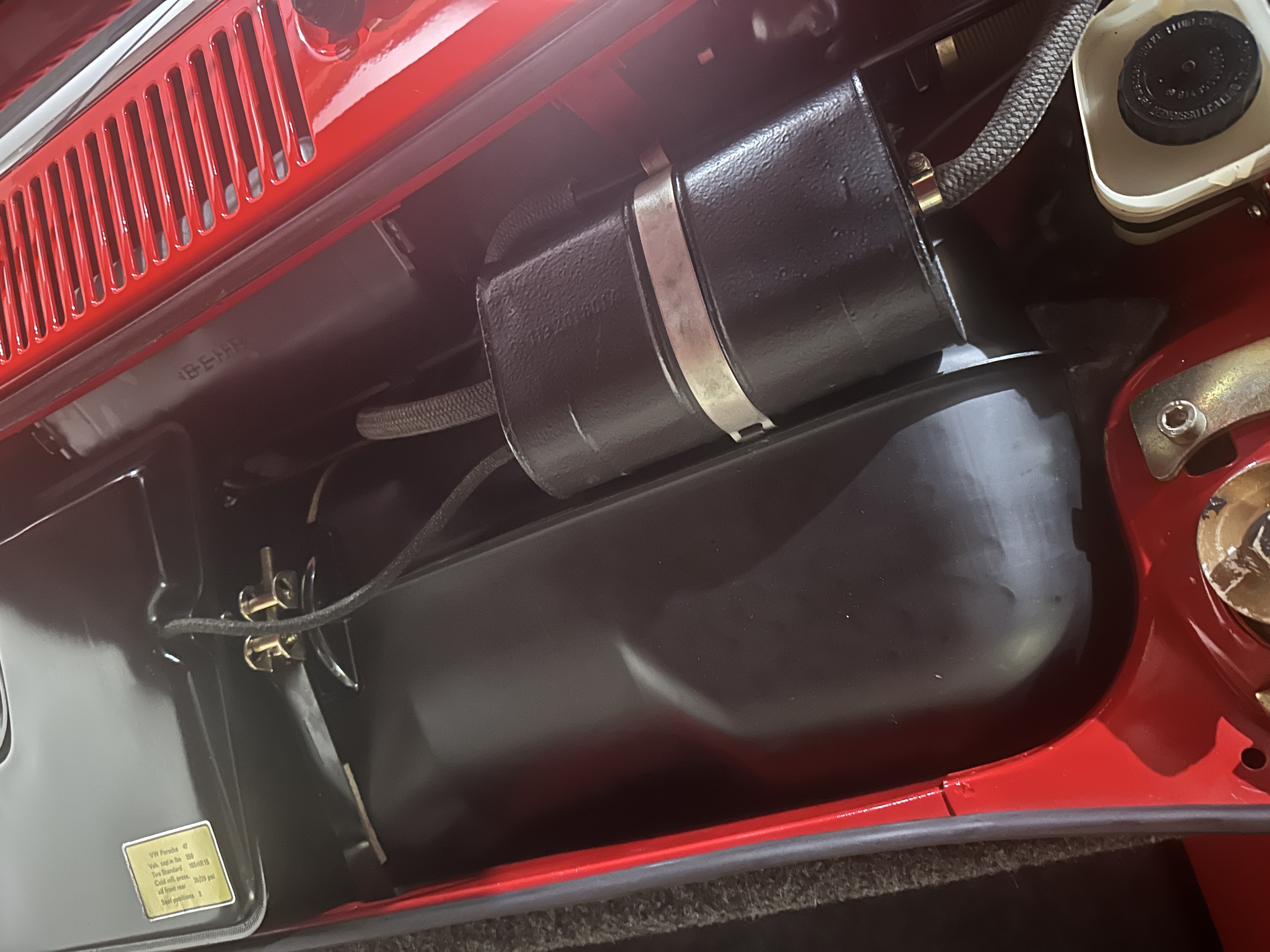

In the past year I've noticed a significant increase in the fuel vapor smell in the cabin of my 73 2.0. I think it's time to track it down.
Is the most likely culprit the charcoal canister? Are there other potential causes?
If it's the canister can these be "re-loaded? I recall hearing that they may be able to be opened up and charcoal replaced. Anyone done that? How big a task is it?
Os do I just look for a used replacement canister?
TIA

The later (74-76) plastic cans can be reloaded with fresh charcoal pellets, the earlier metal cans cannot. I’m thinking the 73s are metal. Swap in the later plastic version.
And check the fuel vapor hoses first, could be that something is awry with the plumbing.

Another likely source are plnholes that have have rusted from the outside to the inside of the gas tank under the ares where the factory put felt pads to insulate the tank where it rests on the body. If the gas smell goes away when the tank is only half fuel, then it’s holes in the tank

I went through this whole process recently. A lot of folks said "it's the charcoal canister", so I set about buying one and getting it installed. It turns out, for my car, it was actually a small fuel leak in the pressurized fuel line under the tank.
Before I could swap in the canister, the small leak became a big leak one morning while warming the car up in the garage. Prior to the bigger leak, I would just get a very strong fuel smell when driving the car, no puddles under the car. Once the leak got bigger, I was finally able to see the puddle under the car. The only other thing that I noticed when the bigger leak occurred is that morning when I went to start the car, it took a few seconds longer for the motor to catch/fire up. (a few more wurr wurrr. wurrrs than the normal two or three rotations of the motor). Now I put that in my mental database to be mindful of when starting the car.
For peace of mind, a guy could jack up the front of the car, remove the steering rack belly pan and look in the big inspection hole under the tank. Get a mirror and a flash light and check to see if any of the fuel lines are wet. Check to see if the bottom of the tank is wet, etc. Had I don't this sooner I would have seen the wet fuel lines and not driven the car around with a fuel leak under the tank.
I have since pulled the tank and replaced every single rubber line, ran the Tangerine lines, etc. etc.
I will be putting the charcoal canister back in this coming weekend. If you need new activated charcoal, shoot me a PM. I accidentally purchased WAY TOO MUCH and now happened to have a lifetime supply. (IMG:style_emoticons/default/biggrin.gif)

This was my problem as well. I bought two replacement gasket rings from the great team at 914Rubber. No more problems.

Usually not the charcoal canister itself but broken lines from the tank to the canister.
If all the lines are hooked up there is no way for fuel vapor to escape into the cabin regardless of the condition of the charcoal.
