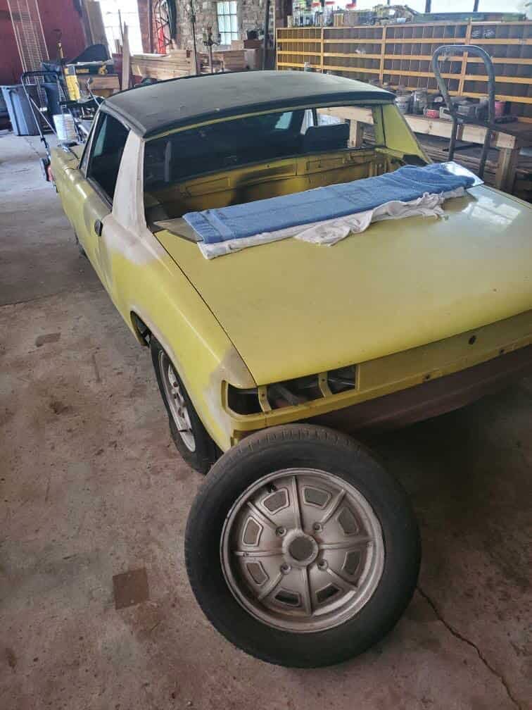

This past weekend I picked up my first 914, a '72 1.7L thats been parked since ~1982. It "ran when parked" but since then the owner pulled most things off it and put them in boxes in his garage. The jack receiver plates have rusted away on both sides along with the door sill triangles and there a little rust on left long in the front. The hell hole looks great though and overall the chassis is pretty clean.
Over the last 43 years, the owner parted out 2 scrap-destined 914s to have some spares for this car. So a lot of extra goodies to work with to get this car running and looking good!
I have a question however, I intend to use this winter to get it ready mechanically but what do you all think would be the best course of action to do so? I want to get the car back on the road, but I also don't want to accidently bite off more than I can chew.
Looking foward to keeping y'all updated!

If you post picture inside and out and a lot of angles, people here will provide all of the guidance that you need
Start with the foundation
The longs
If the hell hole looks good - and the car lived in the Midwest, perhaps the hellhole has been repaired,
Do the doors open and close the windows rolled up?
This simple test is perhaps the best thing to start with

I'll get as many uploaded as i can, the 5mb limit really puts a damper on nice pictures.
The doors open and close well with the windows up. Panel gaps don't look bad (i neglected to actually take a picture of those (IMG:style_emoticons/default/sad.gif) my bad)
The steering felt fine lock to lock and the transmission spun freely.

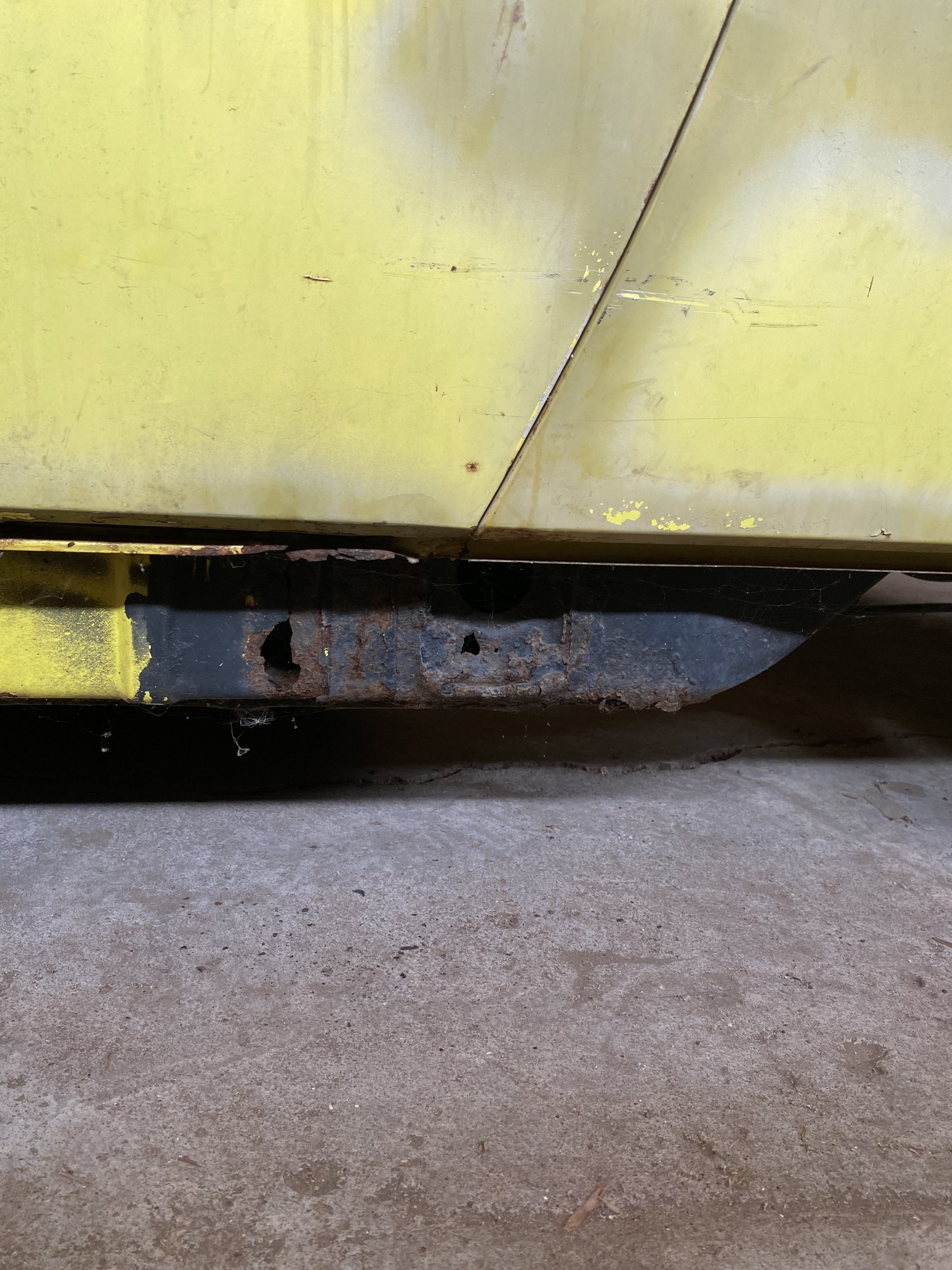

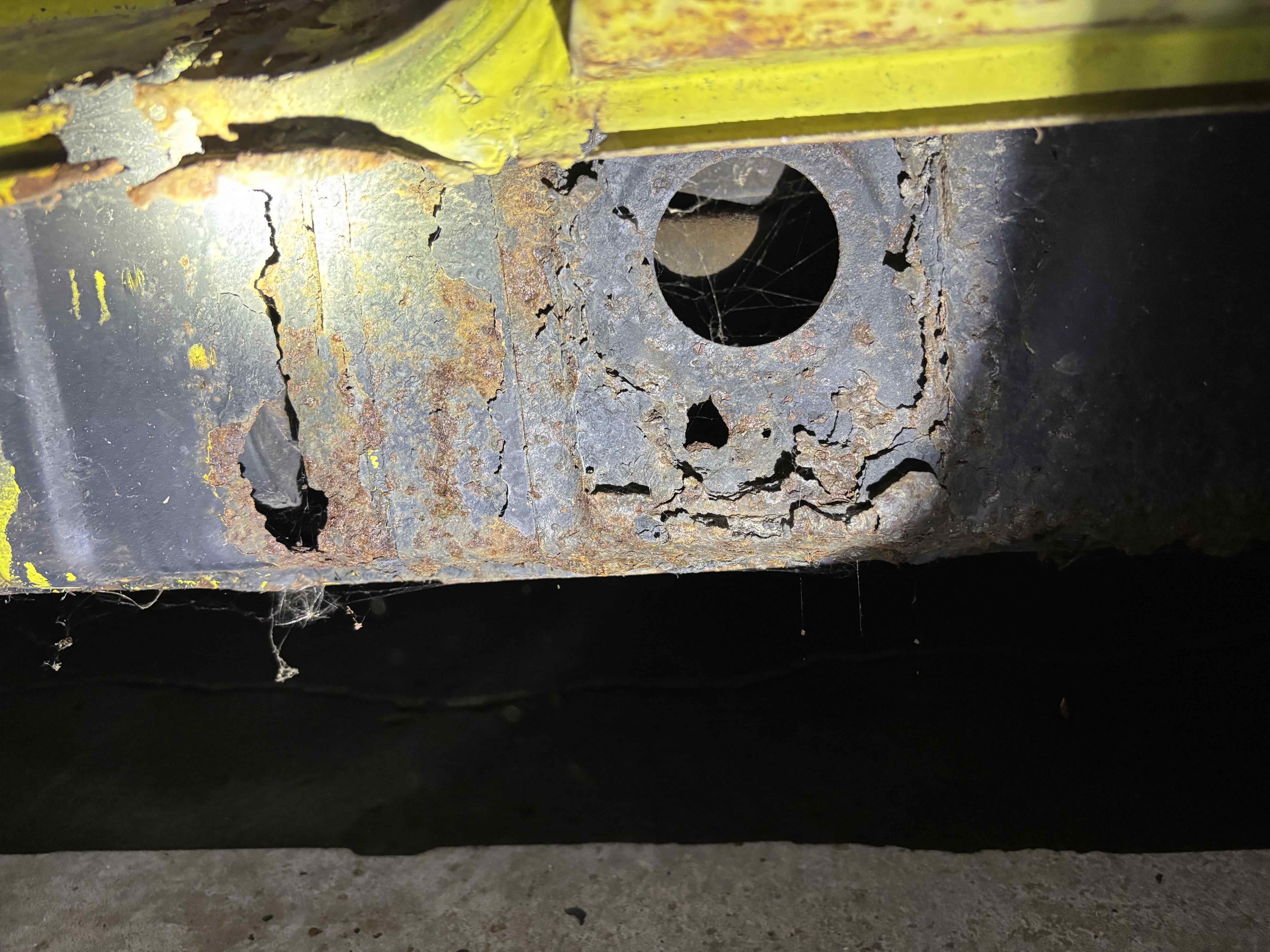

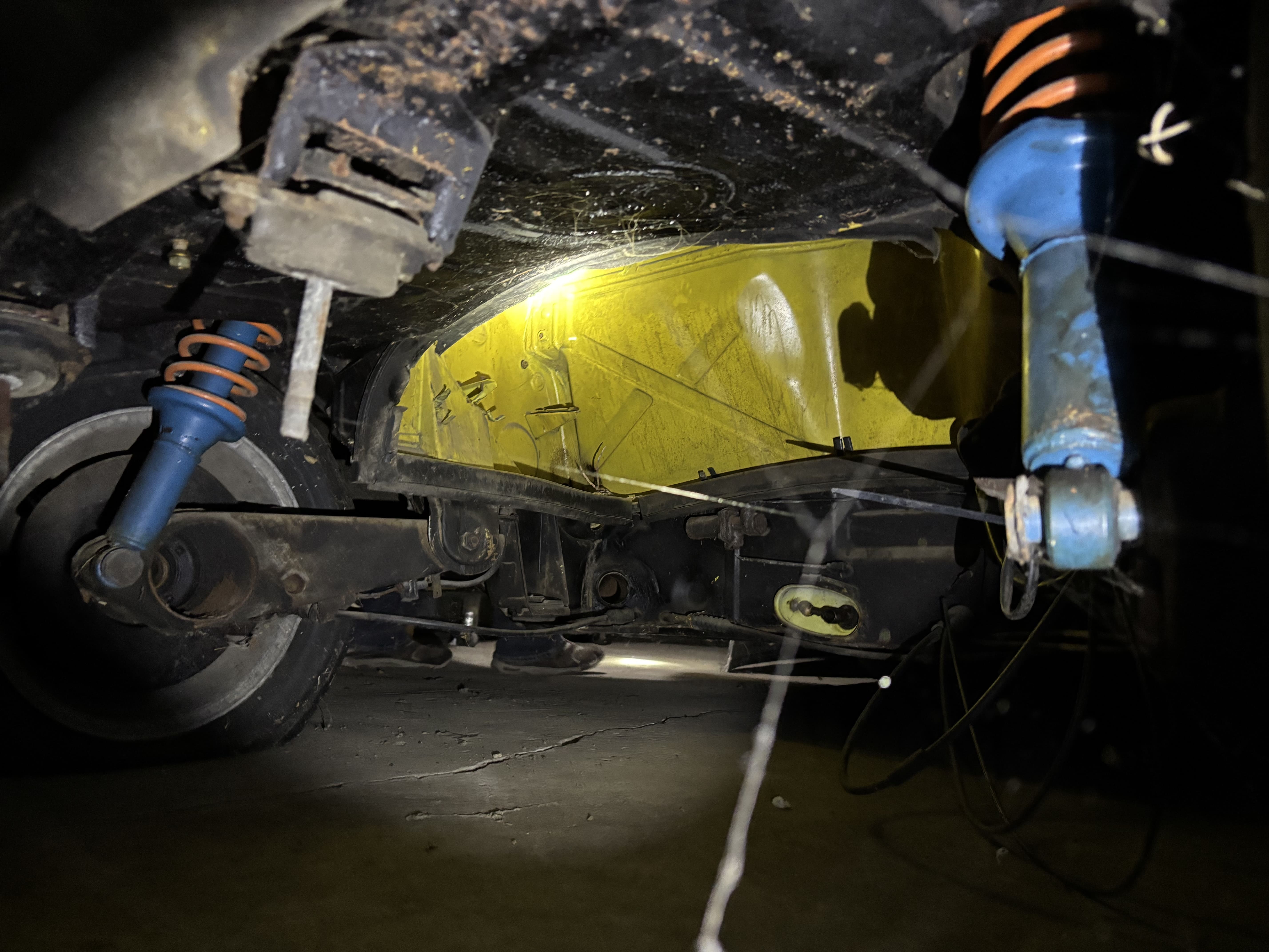

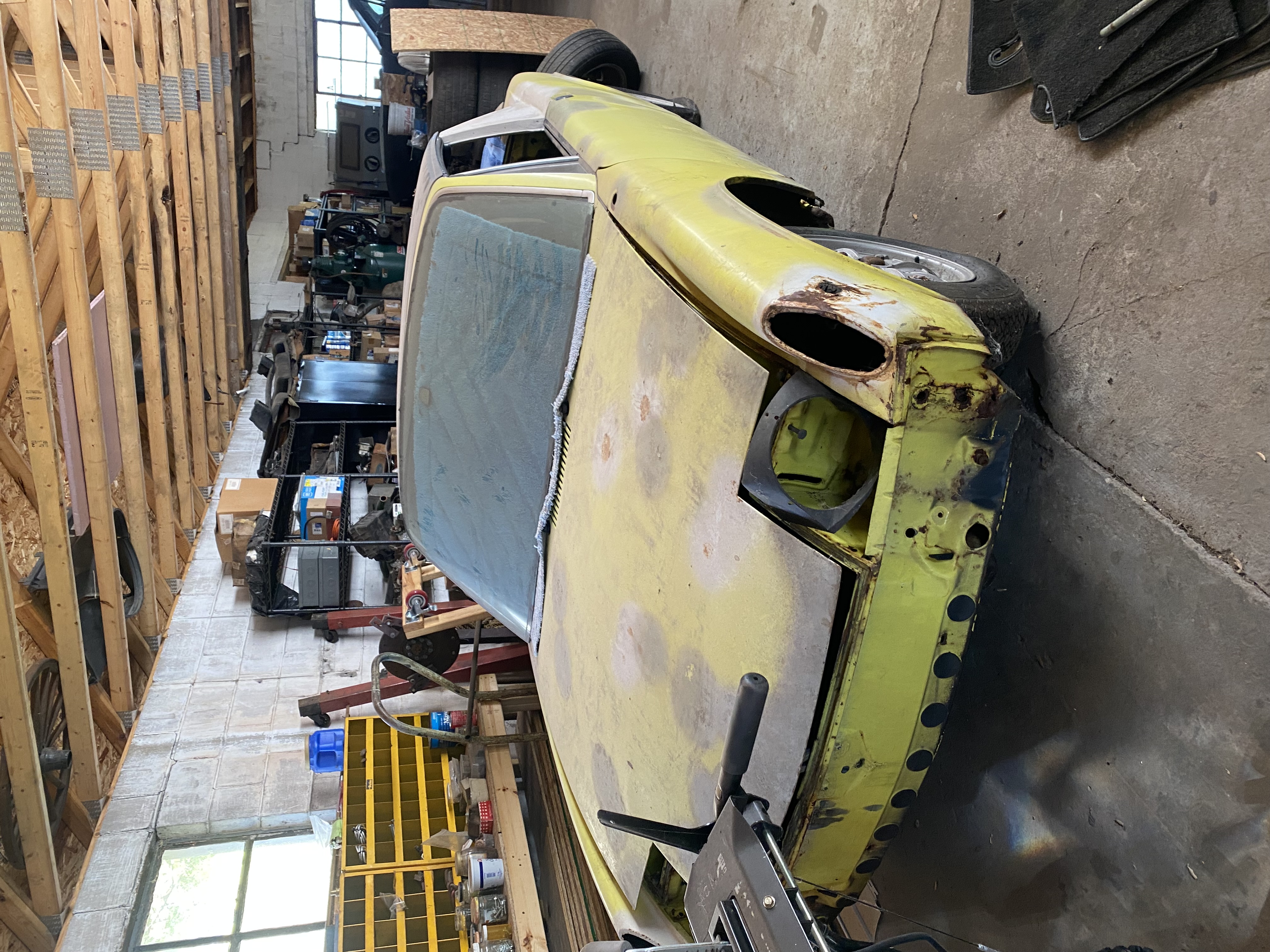

Attached ImageAttached ImageAttached Image[attachmentid=959

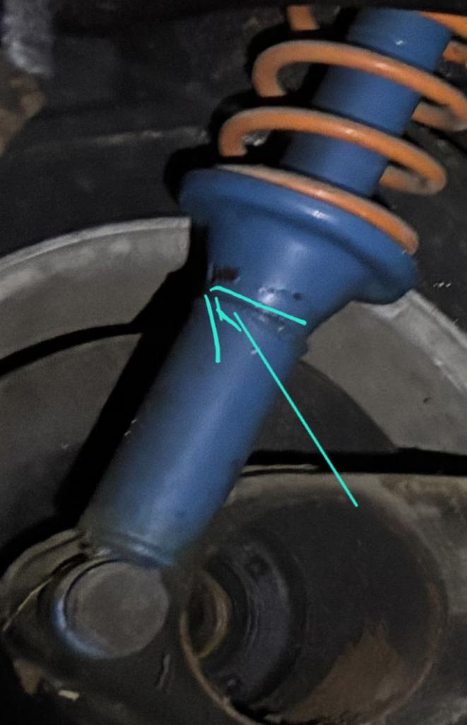

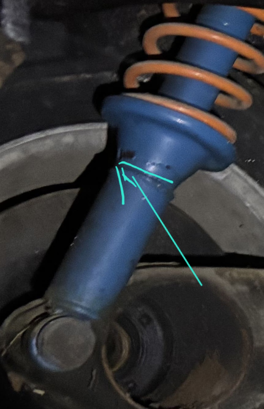

The drivers side shock should have the drain hole on the down hill side.

How good are you with a welder? Both longs are toast.
(IMG:style_emoticons/default/welder.gif) (IMG:style_emoticons/default/popcorn[1].gif)
PS: (IMG:style_emoticons/default/welcome.png)

Welcome! Would love to see the hell hole area too. Agree with SirAndy. This will likely require some fairly extensive repairs to the longs. If you're not in a hurry and don't mind welding, this is fixable.

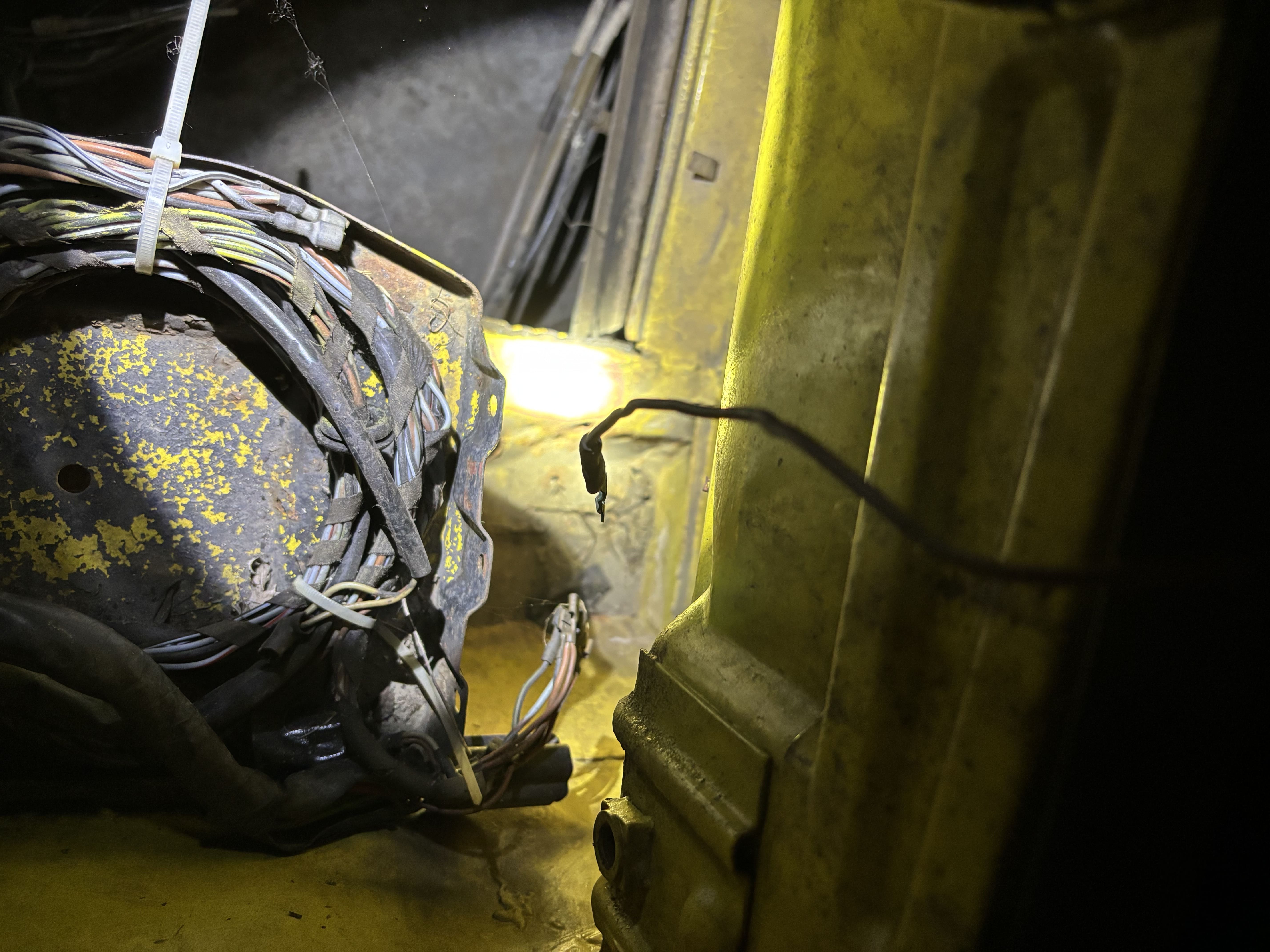

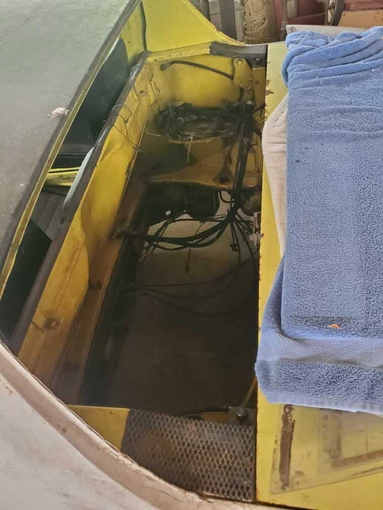

Here's the best picture I have of the hell hole area, from the outside it looks pretty clean. Definitely gonna have to take a closer look at it though.
I'm in no crazy rush (hence getting it at the start of winter) and I would say I'm a better grinder than I am a welder lol (IMG:style_emoticons/default/welder.gif)
