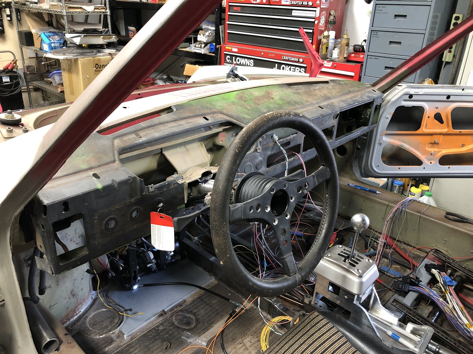

I can confirm what @mepstein Mark says: this turned out to be a lot more work and $ that I would have thought. Not that it isn't super cool and it really does add some frosting to the cake of the build.
Thankfully, that pricey bushing was OK in my column but I did need a couple additional bits to complete the swap. With the new ignition switch and 911 Momo hub, it was just over $1,500 in parts on top of the column and turn signals and wiper switches - which both need a good cleaning to work smoothly. And I still need a steering wheel...
It is pretty cool, though:
