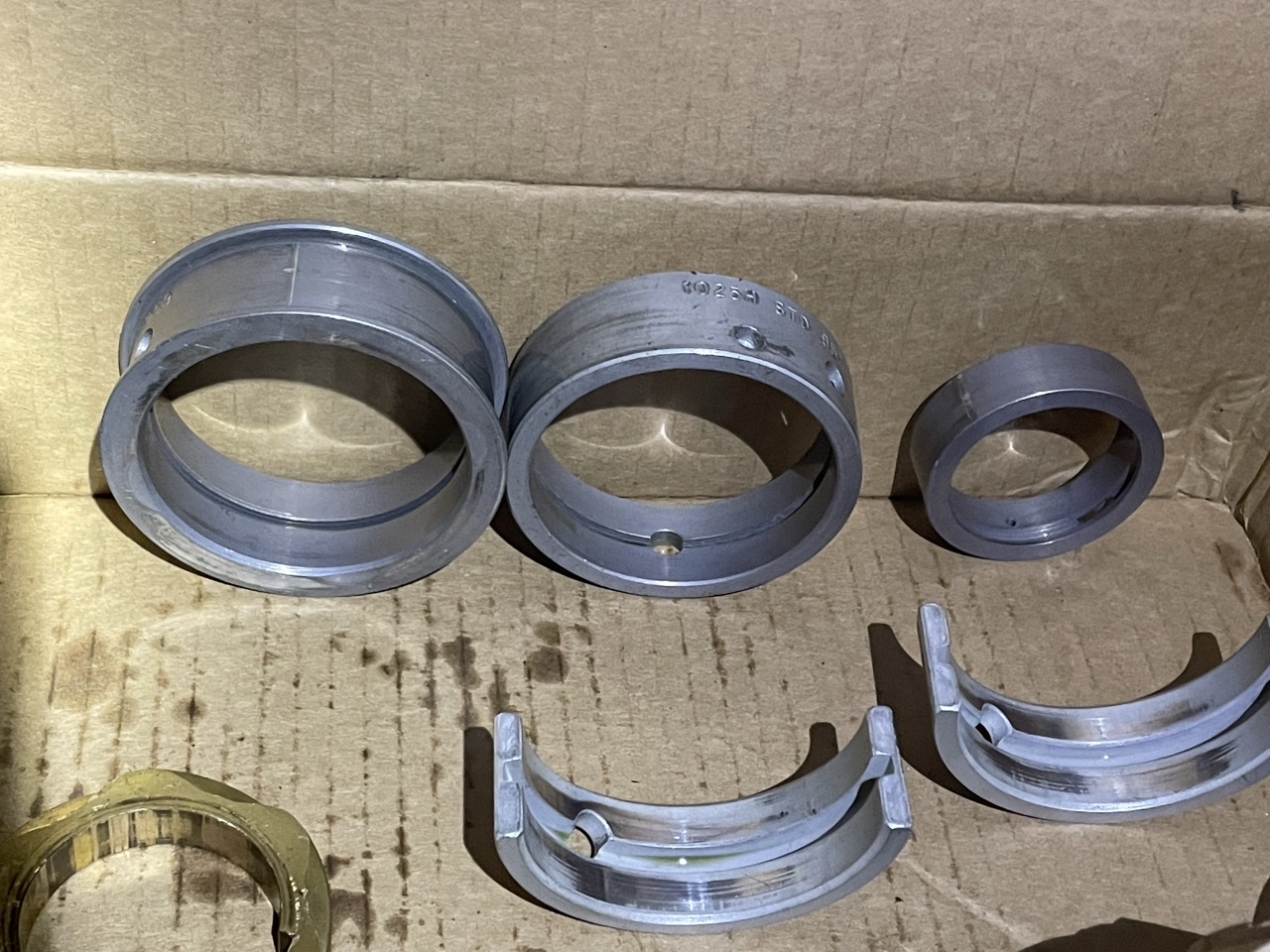

So when I built my engine, I took the crank to a local central Florida machine shop. I asked for it to be checked in every way and turn it down .010 if needed. They called me back up a week later for pickup, and said it was all good and my mains were well within spec for standard bearings. All they did was micro polish it. Before putting it in the case, I checked with a set of micrometers that I had purchased and it was in spec. The car had 85lbs of oil pressure on start up, but would fall to 5lbs after up to 220. I tried everything from different oil pump to the tangerine oil pressure valve, but nothing helped, so I tore it all back apart and started over. The bearings on the ends of the crank looked perfect, but the middle bearing was wiping on both thrust sides. So I bought a bore gauge and checked my case after torquing it back together, and it checked out perfectly. I thought I was going to need a line bore of the case due to stretching, but that wasn’t the issue. So I took my crank to another shop to get it checked out and he put it on the machine right in front of me, and wouldn’t you know the crank was out of round on the middle bearing by .008 ! So I see now why the middle bearing had such extreme wear and my oil pressure was disappearing. They are going to turn it down .010 on the mains and straighten it for me.
I am also putting an o-ringed oil pump back in as well to solve the improper fit issue with the type 1 pump. When I checked the bore of the case and the oil pump that came out of it, they were the exact same size. So the press fit was lacking a bit. Hopefully will be putting back together in a couple weeks once the parts are back in and the machine work is done.

Main bearings

That sucks but it makes sense. At least you know and are now fixing the problem. Hope it all works out this time. I'm waiting word on my machinist but I think I've got the same problem with my aftermarket crank.

Do you recall when assembling the case of the smoothness/tightness of the crank while turning by hand? ie, any indication of a tight fitting main bearing?

No not really…everything felt smooth and normal…

" crank was out of round .008" with the precision required here thats a mile

To get .008" out of round, the machine shop must have done some righteous polishing job ...

Or dropped it off of the counter and wiped off the dirt before handing it back to me!
Either way I feel good that I actually found something to be the cause of the pressure drop. I was beating my head against a wall trying to figure it out.
