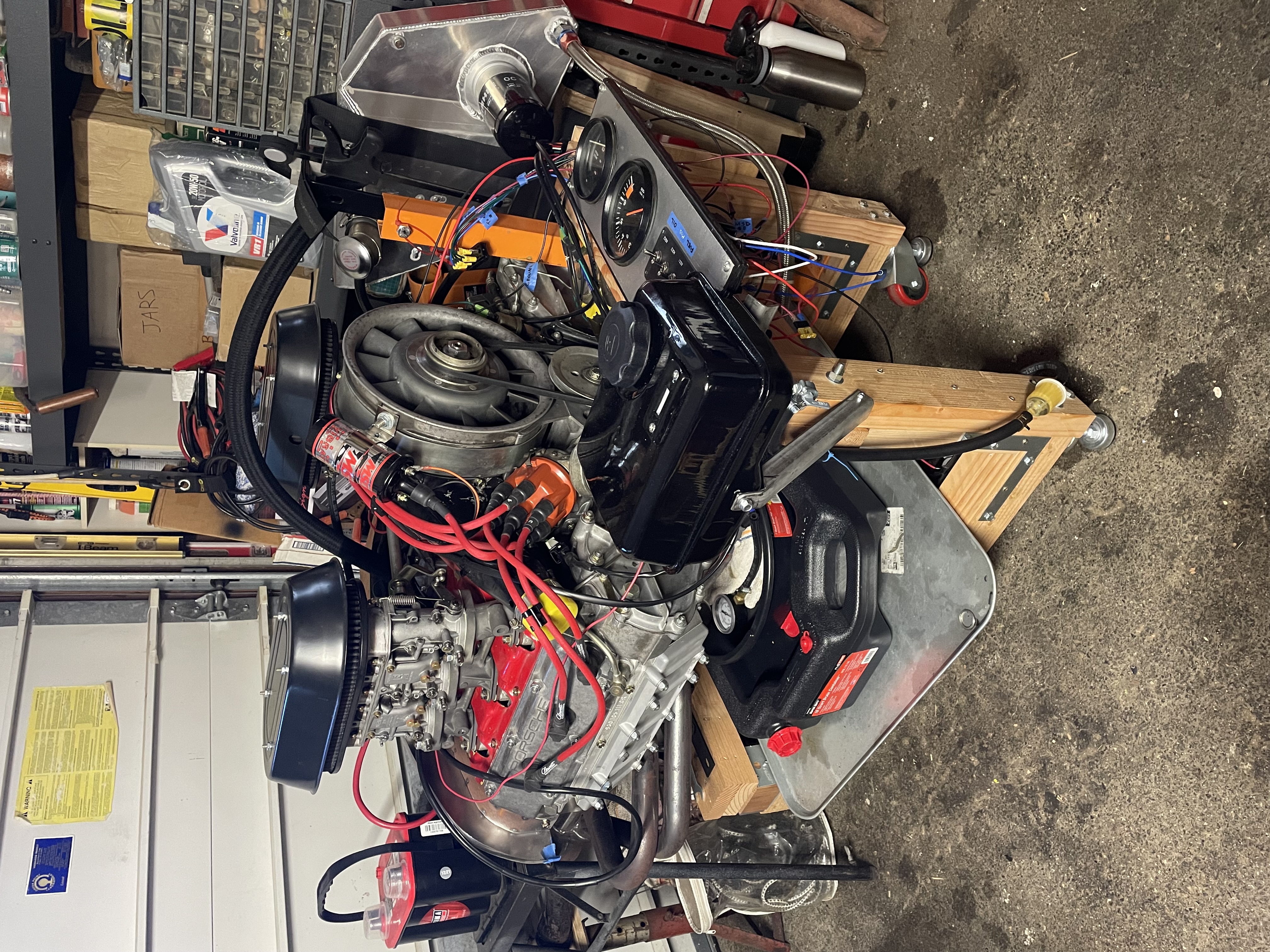

Here’s a pic of my setup. MSD 6AL ignition.

Truthfully it should be titled "low temps on one side"....
It's a complete mess, no hope. I will recycle it for you.
