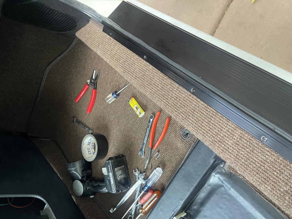

Black screws easy on and off ( stupid little plastic rivets are for people with little fingers)Attached Image

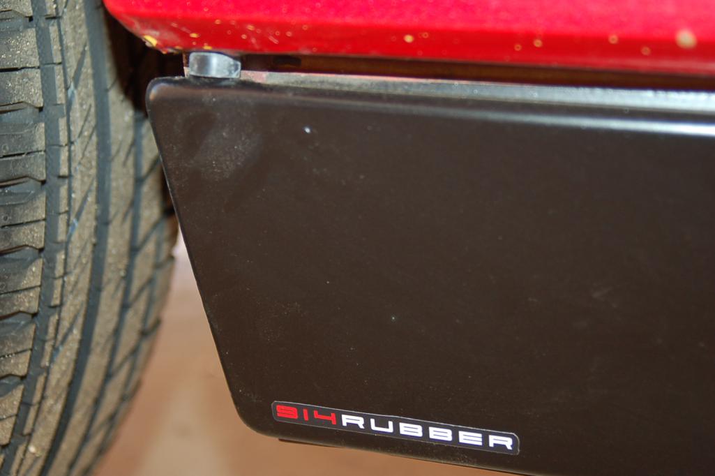

914 Rubber has the plastic Rivets
Those take screws. He is talking about the rocker panels not the carpet strips

I used black screws in both places, worked fine and I prefer this solution for ease of R/R - but not before messing around with the infuriating little nylon rivets. (IMG:style_emoticons/default/headbang.gif)
