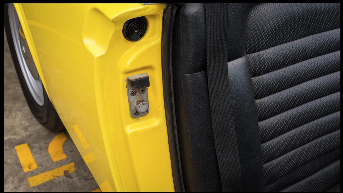

Without a pic, I think (?) you mean the large holes. They are air vent passages and usually have a small foam disc and plastic grid cover. Yours might (?) be missing them.
post Oct 12 2025, 08:59 AM
Posts: 20,721
They didn’t have the vent covers on early cars.
There is a channel from the back of the seat near the window that lets air escape. Without it, it would be hard for fresh air or heated air to enter the cabin.

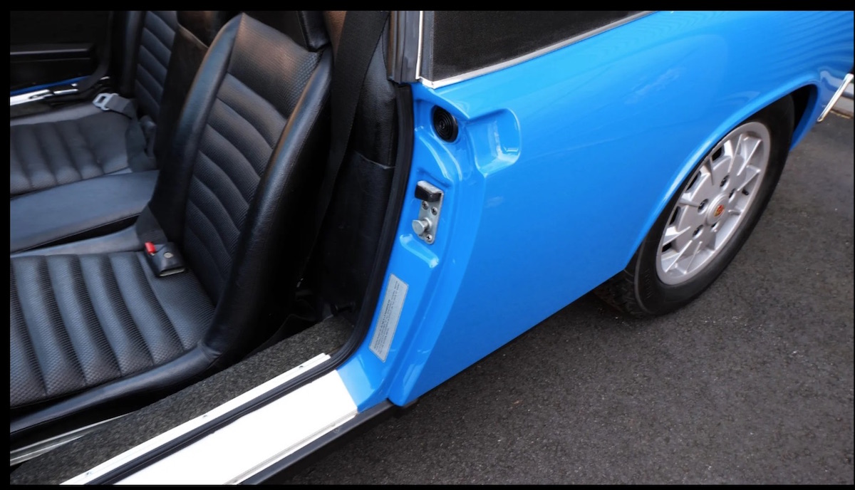

You are correct Andy, the fresh air blower and heat air both introduce air into the cabin. Without the vent the airflow from either source would be negligible unless a window was opened.

here is an interesting one for the general rule of early cars don't have the plastic vent covers.
dr. marchart's personal 74 1.8 (german domestic market).
base spec (non appearance group).
held in the porsche museum collection.
said to be not restored. original condition. very low mileage. less than 20,000 kms showing and also quoted by museum director.
i'm not sure what to make of this.
certainly 74 USA spec cars definitely had the plastic vent covers.
mine does. (IMG:style_emoticons/default/biggrin.gif)
i guess they could have been removed from the marchart car.
but it seems unlikely as the rest of the car is in fairly amazing original condition.
right down to retaining mock ups (adhesive stickers) for 75 model year EGR/CAT lights on the instrument binnacle - interesting artefacts from its time as the personal car of a porsche engineer working the development of the 914 as it progressed.
a possibility is that the euro spec cars did not get the covers, at least in base form.
i have seen a 75 german spec car here in aus, appearance group, that is completely intact and original and been owned by the same retired mechanic since the early 80s. it has the plastic covers.
but i dunno. its just of interest that the museum car does not have them and its a late model. another one of those mysteries.

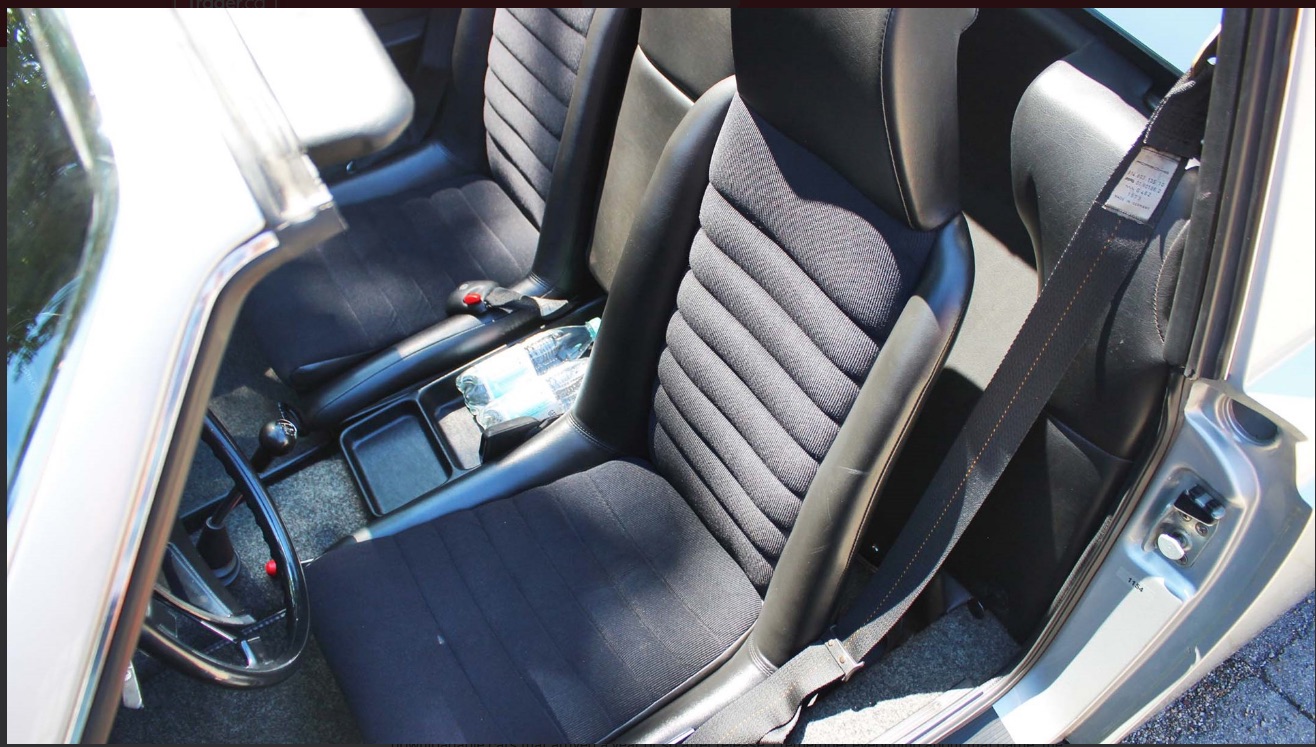

these are two 1970 6s that have been for sale on BAT that were fairly original condition.
but i think both have had external repaints.
seems like the 6s might have always been fitted with them.
the 4 might have been subject to bean counters keeping its price down. a penny here and a penny there? (IMG:style_emoticons/default/biggrin.gif)
