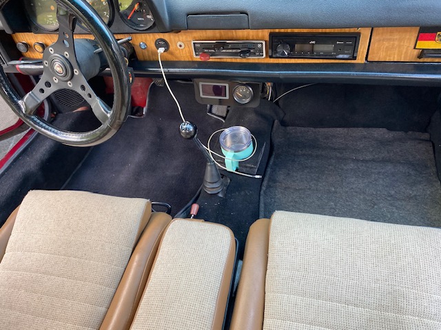

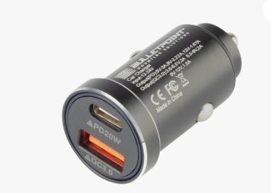

No need to rewire anything if yours is functioning (sounds like the OP's isn't though) just . I use one of these:

That is what i use for the phone and dash cam. the issue is the lighter is not working I need get under there and see if a wire is broken or if power is going to the lighter.
