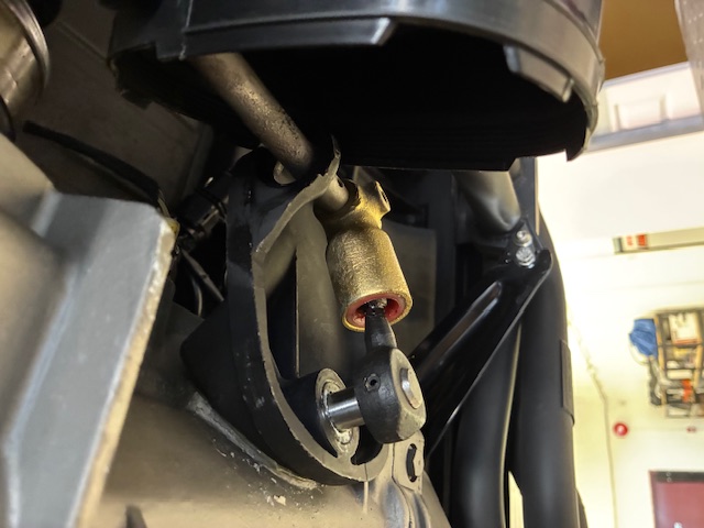

> Shift Rod question
Joec
post Jun 20 2025, 10:56 AM
Posts: 22
Joined: 26-April 21
From: Delta, BC
Member No.: 25,484
I have a 74 2.0 914 and am trying to install the shift rod. Put all new bushing in place but I cannot find anywhere where it lists the bushing where the rod terminates in the side plate just before it attaches to the rod out of the transmission. I think the part # is 914 424 2403 but when i just do a search for this part I get nothing, it doesn't show on any schematics, yet once on different part websites it does show but never really explains where it goes. They all say the firewall bushing and car only needs 1. Please help.

Joec
post Jun 21 2025, 01:49 PM
Posts: 22
Joined: 26-April 21
From: Delta, BC
Member No.: 25,484
again, all information is on the firewall bushing not the bushing on the transmission.Attached Image
post Jun 21 2025, 02:11 PM
Posts: 9,179
Are you talking about shift rod bushing in side shift trans cover

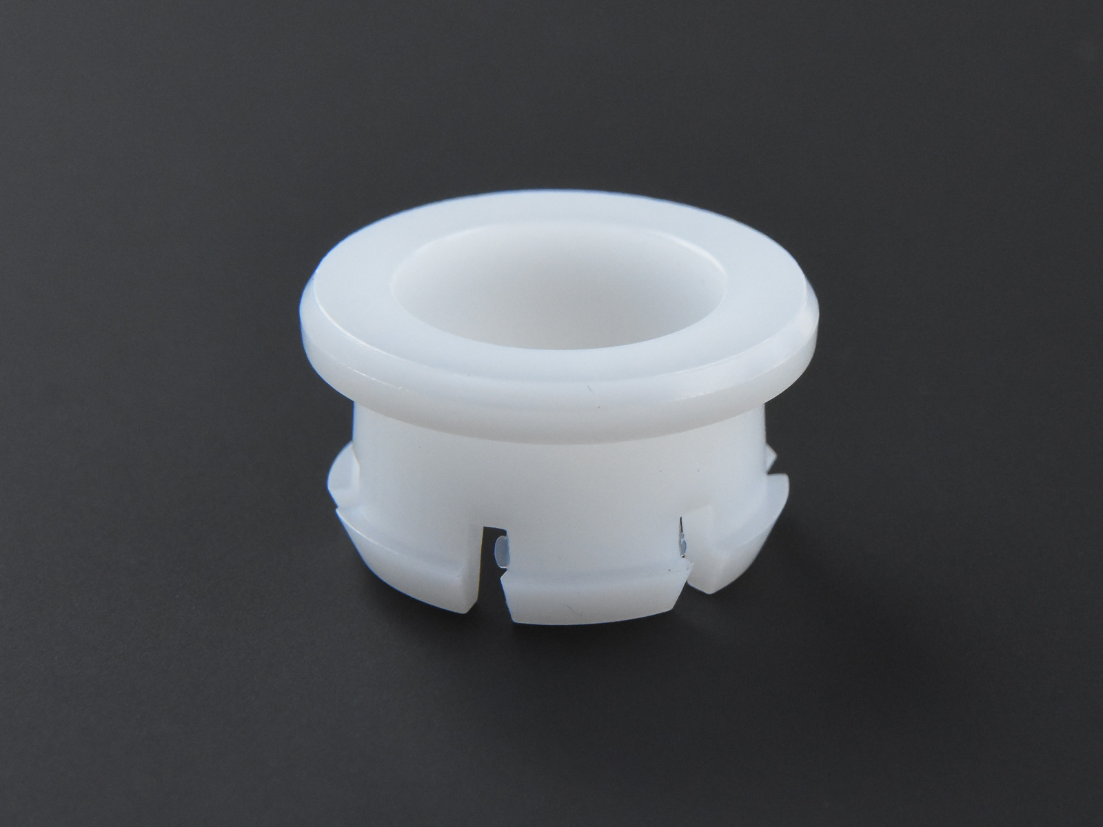

post Jun 21 2025, 02:21 PM
Posts: 1,854
At the gearbox end, you can use the aftermarket bronze bushings to replace the plastic one.
Available at 914Werke: https://914werke.com/shop/ols/products/side...-bronze-bushing
