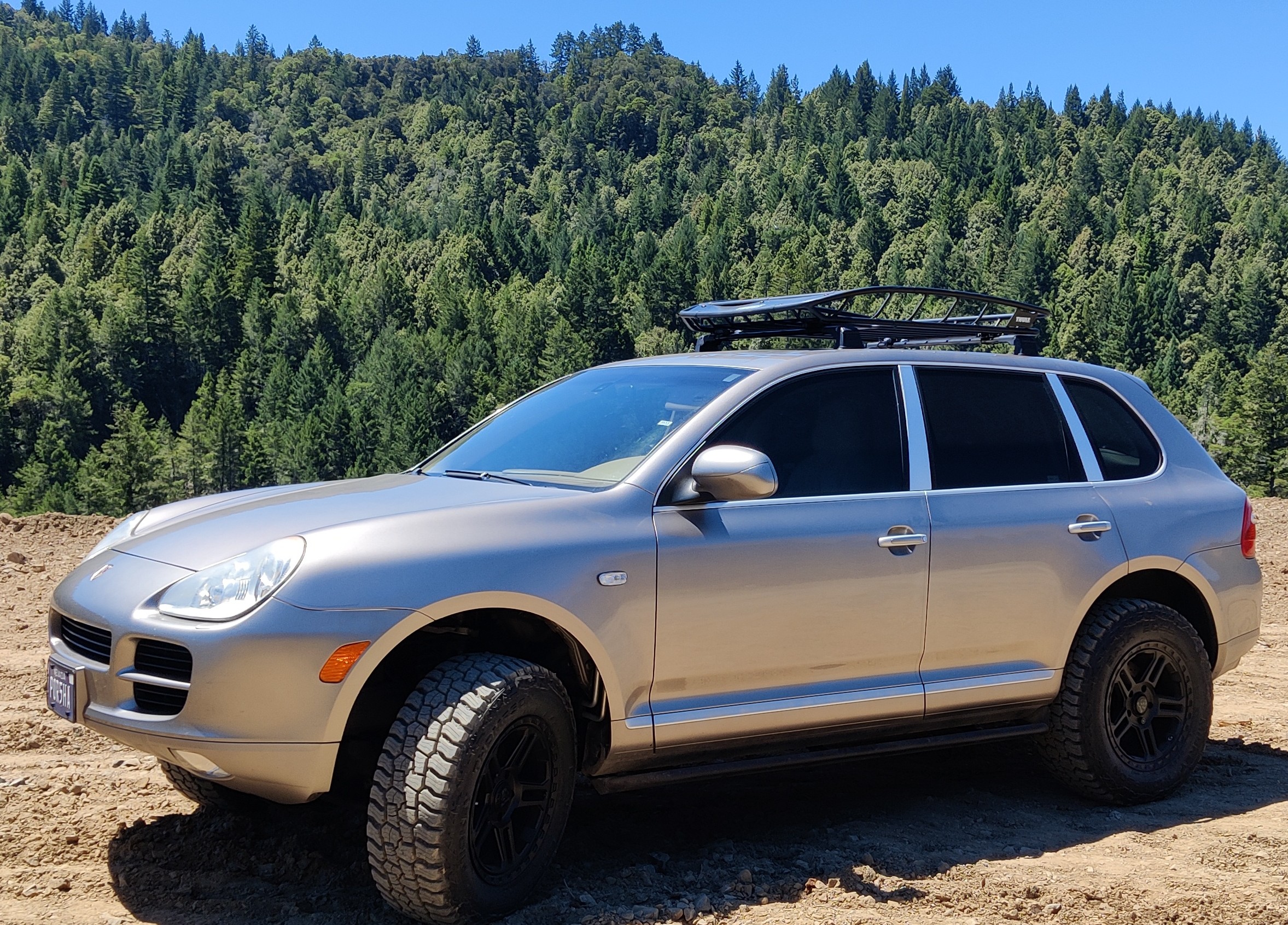

We got a 2006 Cayenne S several years ago (but around 1/2 the miles on it), should have gotten one years ago. Still have it, but with a few upgrades/modifications (like full set of skid plates, rock sliders, big mud/snow tires, lift kit, winch, factory tow package, etc.). It'll take you anywhere you want to go.
Any downsides? Sure. For one, it's a pig. Weighs something like, 5,000 pounds. Gas mileage is terrible and requires premium due to the high compression motor. The rubber center mount on the driveshaft fails. Replaced it already and shortly after purchase. Check it..
Here it is (the gold colored, slightly more subtle one) along with another example of what can be done.

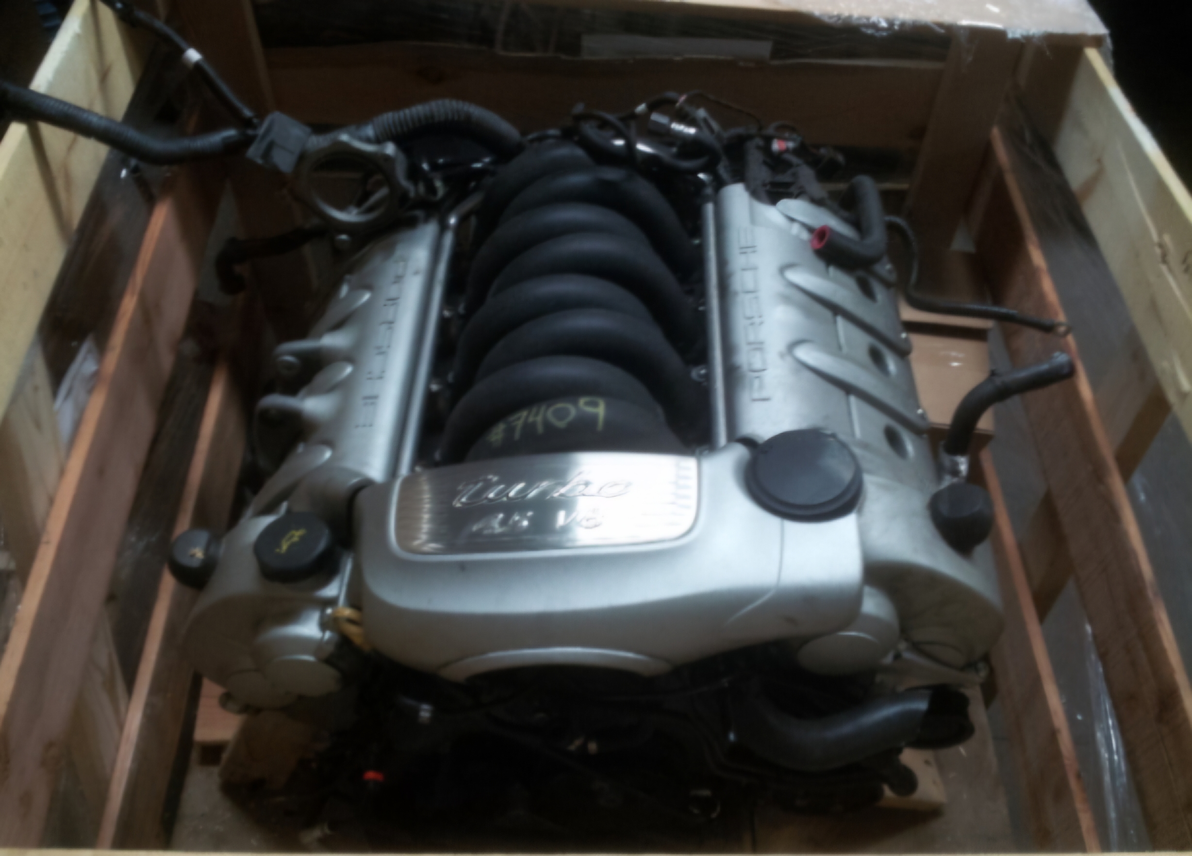

Cayenne engine ('05 Turbo) left overs from our 9148-gtt project;
Complete engine wiring harness (not cut anywhere), ecu, flywheel, intake manifold, misc. I will put this equip up for sale in classifieds eventually.
