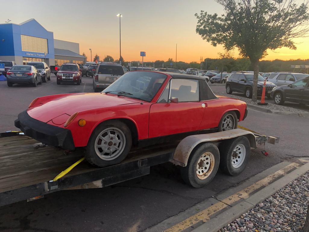

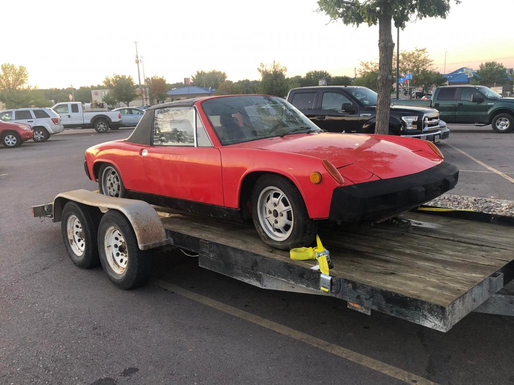

August of 2022, still never having seen the car, I made the 4 hour drive back with my trailer to pick up my new to me 914. I had no idea what to expect and honestly expected the worst. It had been sitting for 20 years after all. This is the backstory I was given, as best I can remember:
In the early 2000s, he took his rusted out 1973 (i think) 914 to a shop in Des Moines, IA to be restored. They ultimately decided to pick up a shell in I believe Arkansas and frankenstein a car together. Thus why my 1975 has a 1.7L in it. Car got a fresh coat of paint and a rebuild and he drove it home. He was then unable to title the vehicle due to the body swap, stashed it in the back of his shed and never touched it again. Unfortunately, after all this time, he was unable to find any of his paperwork or keys to the vehicle.

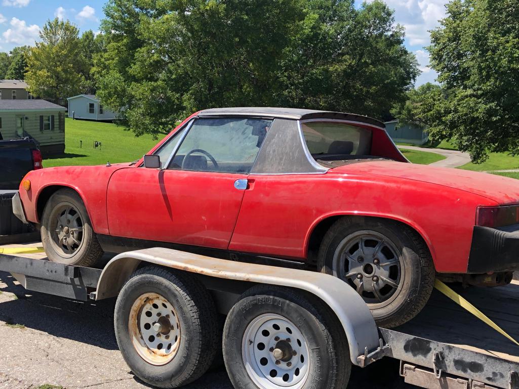

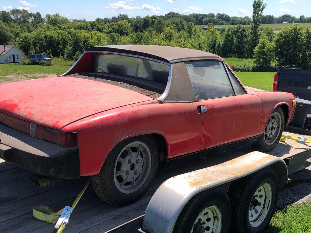

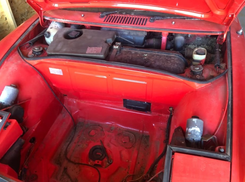

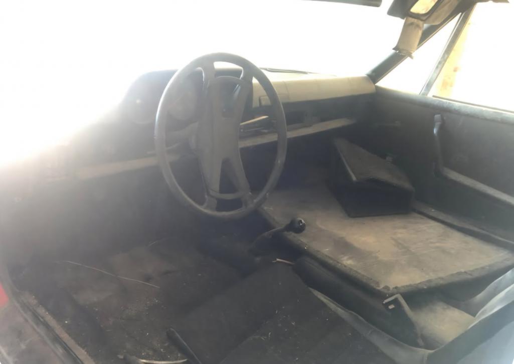

Here's how the vehicle looked after getting it out of the shed.

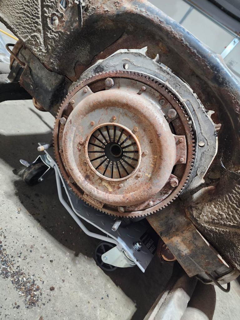

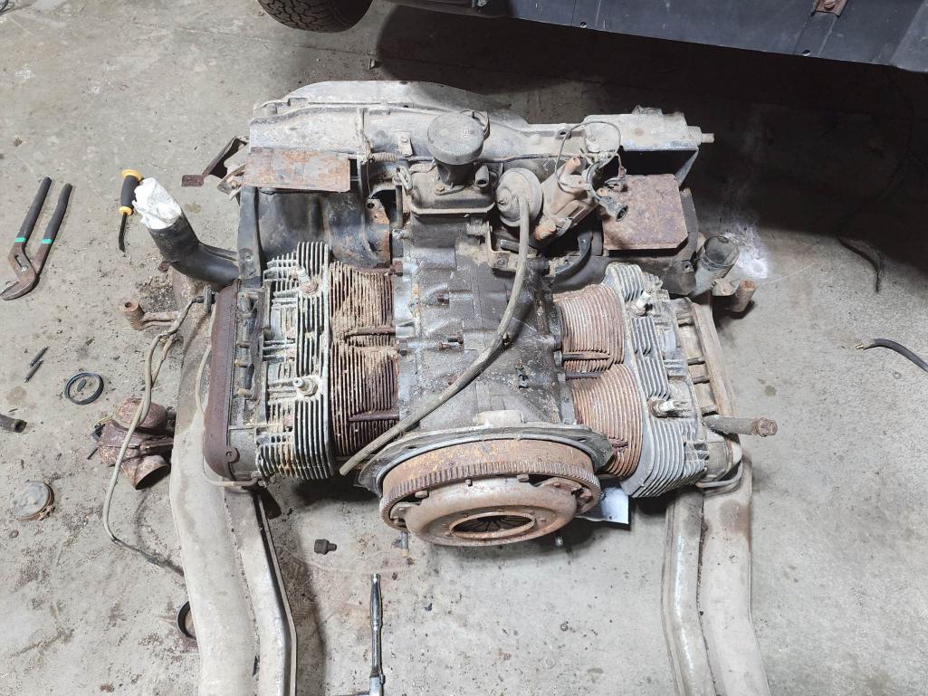

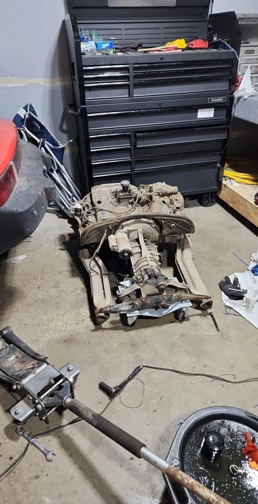

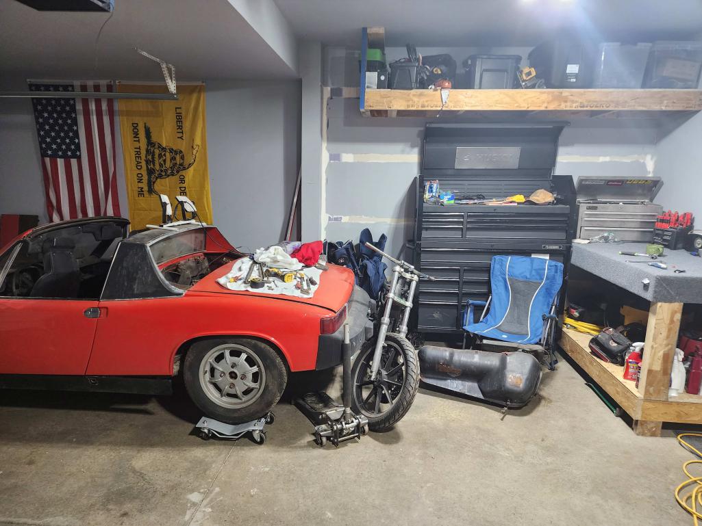

Got it into my garage, and being the overzealous dummy that I was I got to work tearing it down to get it ready for the road. The hellhole was in great shape, the cylinders, pistons and heads appeared to be in great shape. Im glad i did not try to start it as there was some nests inside the tins that would have blocked the cooling flanges from opening. What confused me then and continues to confuse me now is the rust. The body had no rust, very very clean. Far from perfect but clean. Not surprising considering it had been stored inside. But the exhaust and heat exchangers had completely rusted through, The engine tins had a lot of surface rust and in some spots had begun rusting through. The jugs of the cylinders had a lot of surface rust, several of the bolts for the tins were rusted to the point they snapped with very minimal force applied, even with PB. Back to the dummy part. In my haste and inexperience, I got straight to work. Gutted the interior, dropped the motor, pulled the gas tank so I could replace all the gas lines. Dissassembled the motor. I didn't document anything well enough. I thought I'd be putting this car on the road in the matter of a few months and could operate from memory reassembling.

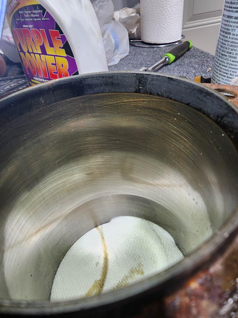

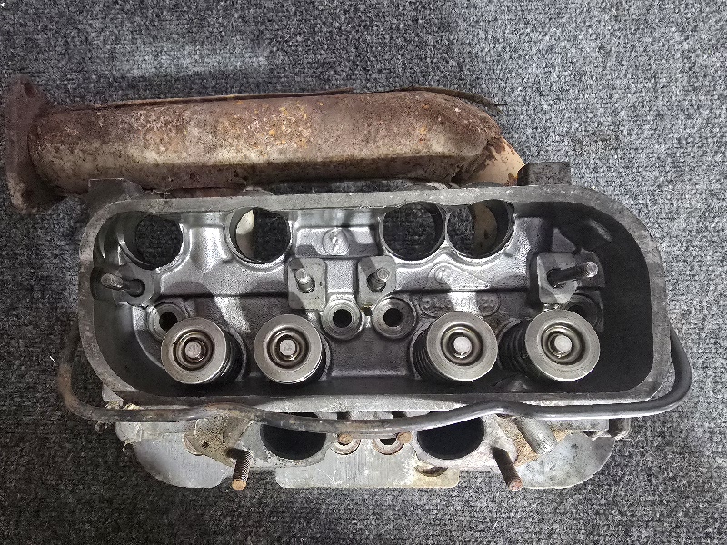

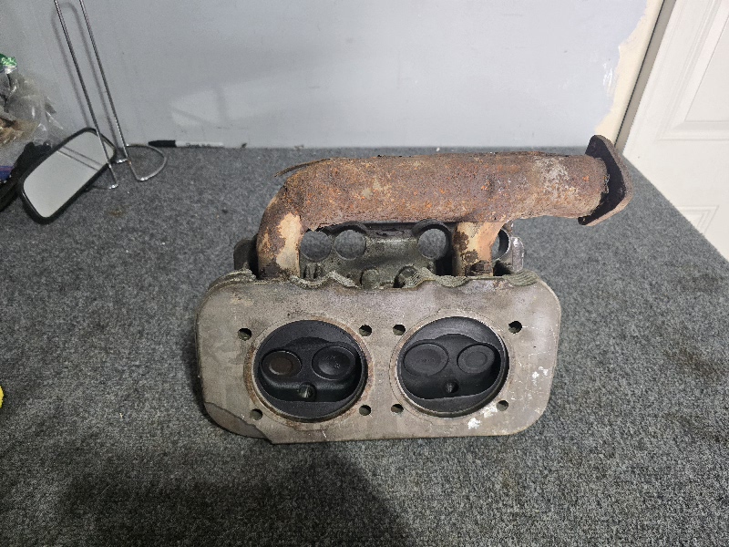

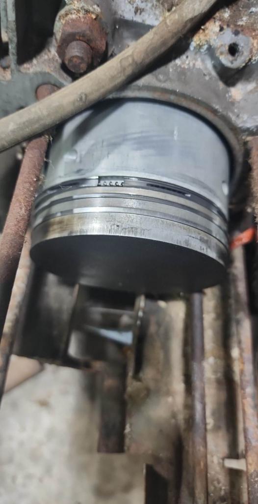

Good news! As previously stated, the guy i bought the car off of offered very little information. I was able to determine on initial tear down that the case was a 1.7case and didn't really look past that as it made sense as he said the motor came out of a 73.

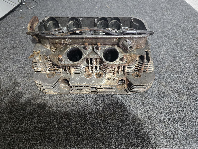

Today i measured and it already had 96mm jugs on. So either the heads were machined or swapped for 1.8 heads. Rough measurement of the valves shows a 39mm intake, 33mm exhaust, which from what i understand means it is a 1.7 head. If the heads were already worked for 96mm jugs is it still worth it to look for 1.8 heads?
Pictures of heads. Need to be cleaned and probably decked, although if it has only ~200 miles since the heads were redecked, do i need to worry about that?
