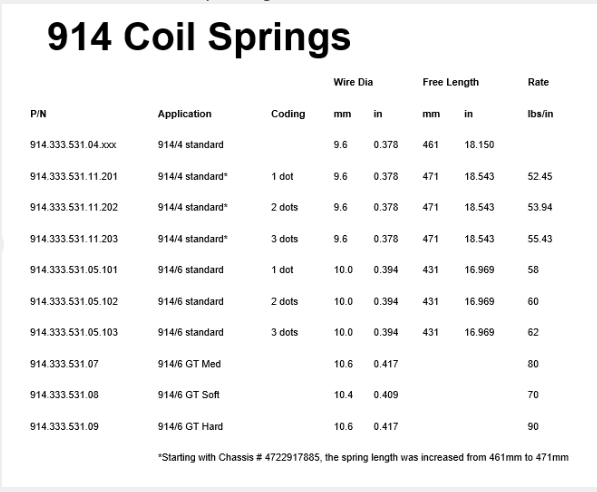

Here is a question to think about
If you are running a 2000 lb car and doing so on the street why would you need rear springs that are 55% stiffer than the GT ran?
There is no right or wrong answer it all depends what you’re trying to achieve with the car (which you haven’t stated).Attached Image Attached Image
