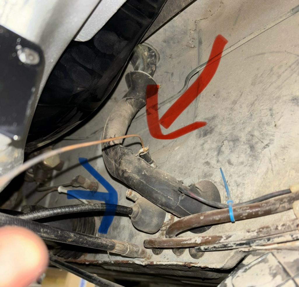

This is the 74 that had the misrouted accelerator cable. That has been removed so now I have what I believe is the original accelerator cable, the arrow is pointing at it, which is good in stock in the tunnel.
Even with vice grips on it, I can’t pull it out and it doesn’t really wanna move forward either.
I’m going to have to remove this before I install replacement cable so any ideas or suggestions?

That's not the hole for the accelerator cable. That's the hole for the heater control valve cable. You can tell because it is flared on the end. The accelerator cable tube is not flared and is lower to the left.
The heater cable removes from the inside, as it is a U shaped cable. You have to remove the heater control lever and pull it out to get the cable out.

And I will add that is definitely not the throttle cable. It is a stranded cable. That is a solid wire used for the heater control valves.
The throttle cable is the one above the speedometer cable and to the left of the wire snorkel in the picture.

Oh man? This poor car and somewhat clueless current owner (me)
Cable should run through where the blue arrow is pointing?

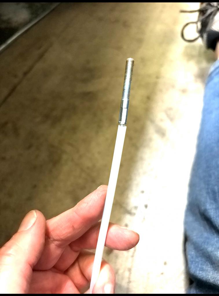

The replacement accelerator cable won’t fit into the opening with the blue arrow.
Can’t see anything stuck I the opening and the old cable came out OK. The old cable did not have the white sheath, but that should make a difference because that isn’t wider than the top of the cable that the ball cup screws on to.

QUOTE(Tdskip @ Feb 10 2025, 02:35 PM) *
The blue arrow is the correct location for the throttle cable.
It may have the remains of the cable sheath in it. I would start with a coat hanger wire and try cleaning it out.

QUOTE(Tdskip @ Feb 10 2025, 04:09 PM) *
Your new cable won't fit because the crimped-on end of the old cable sheathing is still on the end of the cable guide tube.
In the picture with the blue arrow, you can see the end of the tube where it points has a hexagonal shape. This is because the piece you can see is actually the end of the sheath -- it gets hex-crimped onto the plastic sheath and fits over the stub that sticks out of the lower firewall.
Take a pair of pliers and carefully twist the sheath end off the cable guide tube. If it won't come fairly easily, use a torch to heat the end and then try again.

OK - One step forward,one step on hold.
Removed the sheets from the cable that was in there before, it actually came out pretty easily once I knew what I was doing. Thanks for your help..
Unfortunately, the replacement cable doesn’t want to slide into the opening, seems like it’s just slightly oversized. Looks like maybe there’s a kink or bend in the tube? Maybe?
