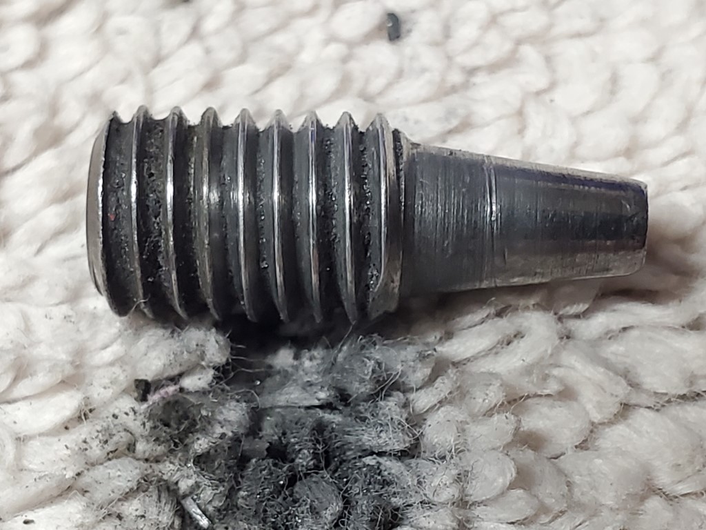

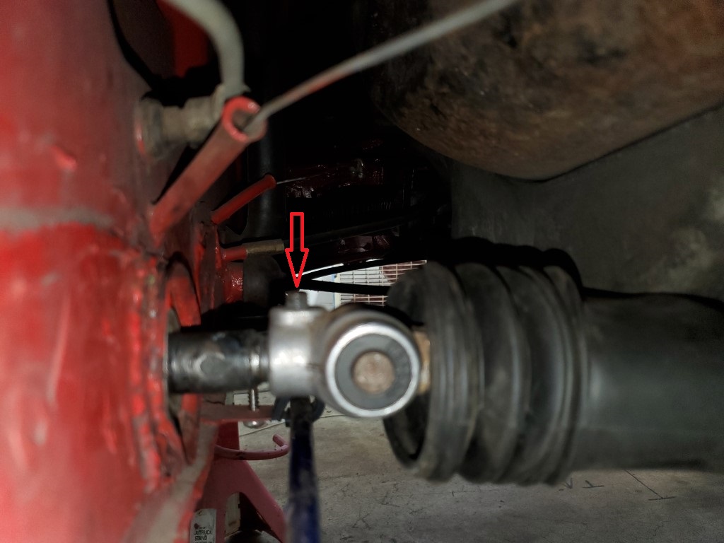

Every 6 months I have to retighten the cone screw on the shifter. This time it came out real quick. I thought it might come out all together. I couldn't get 2nd without hitting reverse. The picture shows how much the screw backed out.
Not sure how much torque I applied but I was bending the allen wrench.
Questions:
Should I have thread locker on this?
What is the torque required for the cone screw?
Possible that the threads have been widened by repeated looseness?
Why didn't they put a bolt through this to really lock the hub onto the shaft?
TIA

Intended to be one time use
Replace both. And you’ll be done

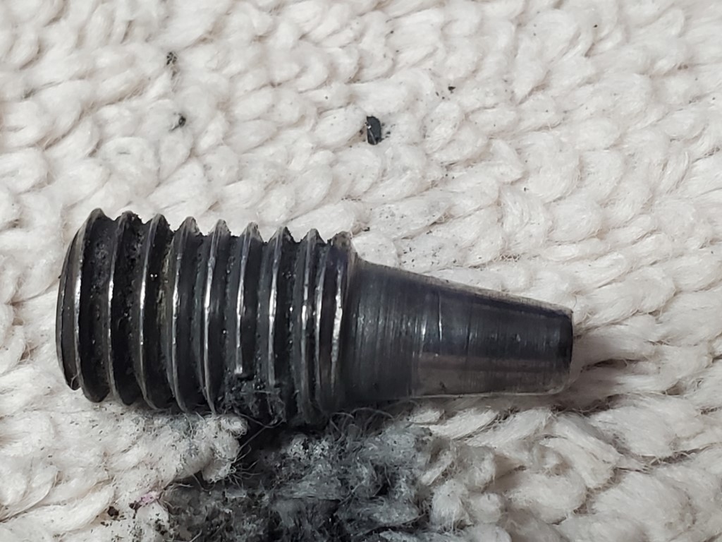

The cone screw thread appears to be folded over at the bottom. Really messed up.
Looks like maybe the cone maybe is hitting the top of the pocket in the shaft (rolling the 1st thread).
Hard to say if the cone screw wasn’t machined properly or maybe the pocket in the shaft is getting enlarged by having been loose for too long.
Inspect
Remove 1st thread if needed to allow the set screw to seat fully in the shaft pocket.

Unless their worn or partially stripped, I just put blue loctite on them and reuse them. But yes they are one time use. Some of the new ones i received have a hole in them with a plastic piece to keep it from coming out, but the plastic piece that holds it in, only works once.

A small amount of blue loctite is all you need.
Though as buggered as those threads are I'd get a new screw.

Inspect the threads in the coupler carefully. That screw may have torn up the aluminum as it was removed and may necessitate a helicoil repair to the coupling.

Indeed, also the first of your 2 pix shows a void in the threads where a silicone anti vibration, anti backout slug, would be sitting in a new factory screw. Both of those items likely causing you backing out.

First time I've seen a cone screw facing up. Is there something else going on here?

I cleaned up the first thread on the cone nut and reinstalled with loctite but there was nothing left of the treads. The threads are stripped. So either heli-coil or new coupler.
maybe the OP is in Australia?

Man I have seen a lot of 914s and their shift linkages but wondering why the cone screw is at the top versus the bottom like all of the ones I have ever seen seen?
