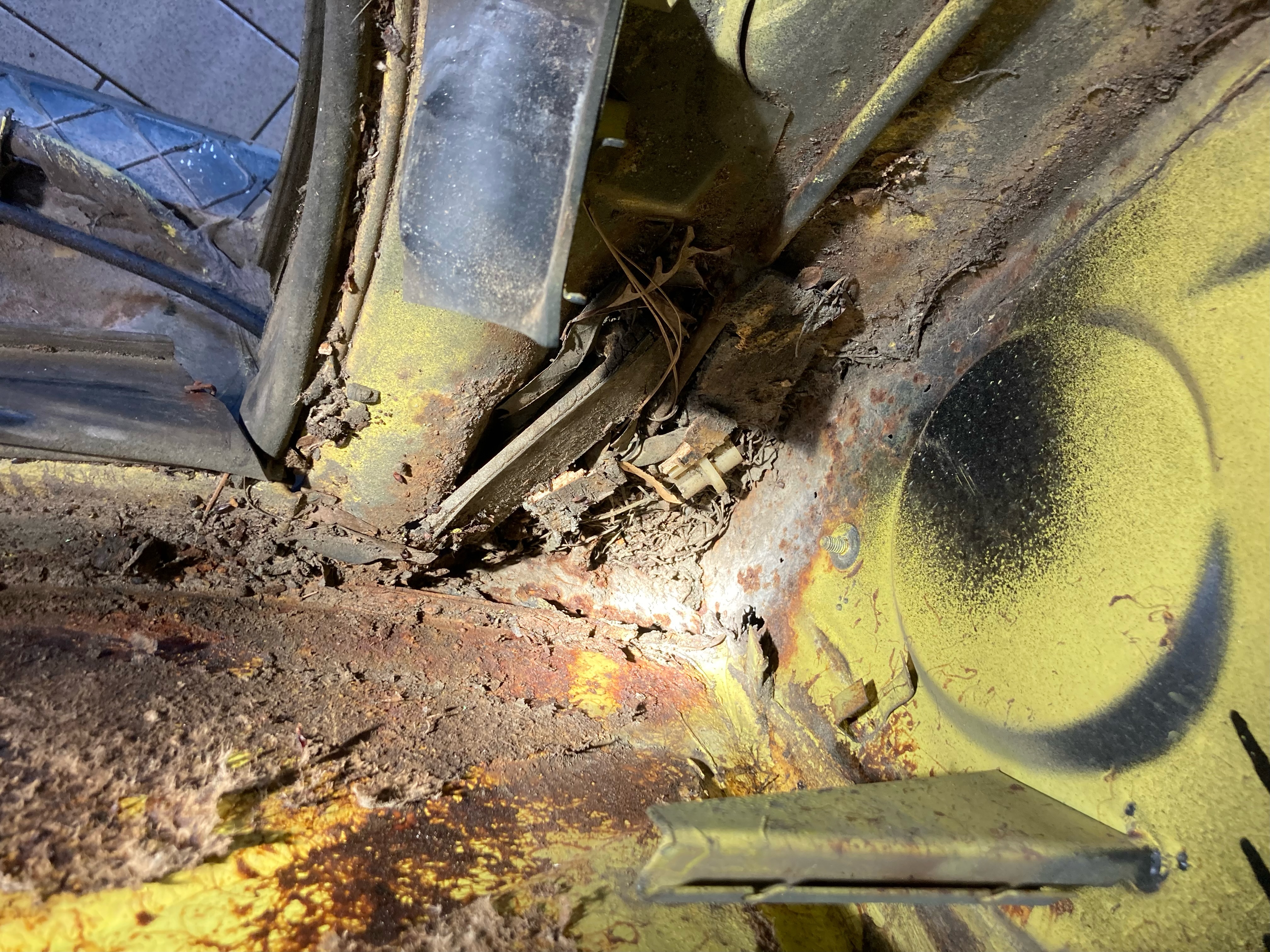

I’m a newcomer to the air cooled world. I picked up a 1975 914 1.8 project car last Fall that I’m just now beginning to work on. It seems to be mechanically stock and structurally sound and has ~120K miles on what appears to be the original engine (it doesn’t look to me as if it’s ever been pulled).
I found it on Craiglist in Maine where it was in the hands of a VW bus/bug enthusiast who was the third owner and had decided to focus his energies on a bus restoration instead. It was last registered an on the road in 2017 when the second owner had it. When I bought it it lot drove and came with an assortment of Restoration Design repair panels, several spare doors from earlier cars, some foglight front bumpers, spare seats, etc.. In a first for me when it comes to project cars the electrics all function properly and appear never to have been monkeyed with. Lights, blinkers, engine heater fan, hazards, everything.
Photos below tell the story but the worst of the rust appears to be in the aft section of the LH outer longitudinal. I haven’t pulled the battery and ECU out yet, but from what I can see underneath the car, inside the engine bay, and between the quarter panel and the engine compartment tin the hell hole appears solid (but I’m prepared to find surprises). The rear of the car seems worst off with rot from the foam above the tail lights partially cut out and partially corrected (I’ll be cutting that all back out and starting the job fresh). It was also hit from behind on the LH side and although I haven’t measured everything out yet, from what I can see underneath things don’t seem to be out of whack (maybe wishful thinking as the panel gaps for the rear trunk are uneven). The trunk lid itself somehow didn’t rust out along the rear edge, but it’s suffered a lot of abuse in the form of a now missing luggage rack and a black fiberglass spoiler that had been attached with wood screws. The front of the car doesn’t show any signs of impact damage but the trunk lid sits high when latched on the LH side.
My plans are to do a driver quality restoration (between a Hagerty 2 and 3) and get it on the road where I can enjoy it; I’ll cut out and weld the rusty sections, do as much of the body work myself as possible (thankfully it is very straight and the paint meter indicates there shouldn’t be a lot of bondo hiding under the old re-spray) and get a professional re-spray at a local body shop. I’ll either farm out or attempt to DIY the engine work myself. Since I’m assuming the engine will need a rebuild (see below) I’d definitely like to increase the displacement while staying with the stock FI setup.
I just started assessing the car in the last couple of weeks and have focused on the health of the engine. It’s still got the original L-jet FI (which I intend to keep). When I got it, it fired up easily but was extremely lumpy and stumbled badly coming off idle. After fixing vacuum hose routing (mostly anyways), adjusting points, doing timing, and adjusting valves it idles well at 850 rpm, sounds much healthier, and revs up from idle nicely (all this is based on stationary testing as the car is not on the road).
Today I warmed the engine up and did compression test (throttle propped open with screwdriver) followed by a leak down test. I think the results tell me that I have a tired engine needing rebuilding:

You have a running engine...
And you going to need a bunch of rust repairs...
I'd not worry so much regarding the engine.
If it has been in non-use for some time you need to put it under load to help everything reseal. Just warming it up doesn't clear all of the problems.
Drive it around like you stole it and I bet your numbers will improve.
Having all the compression numbers exact says two things. It's in pretty good shape AND your valve adjustments are consistent.
The biggest factor that effects compression readings is intake valve closure point and yours are all damn close to each other.
My 75 1.8, that sat 33 years, and really has less than 32K on it hit 120 on all cylinders but leak downs were 4-12%. This was cold but you can see you are close to my numbers.
These engines are now EXPENSIVE to rebuild, and it appears few machine shops can complete the machine work properly.
Even Ian Karr's Bumble Bee had trouble and he's a "cost no object" type of guy.
His videos are all worth watching...
https://www.youtube.com/ @IanKarr
In your shoes I'd concentrate on body stuff and educate yourself regarding an improved engine. Often times buying a stalled project can reap dividends.

I hate to break the news to you but I can see a full-on rustoration ahead. Once you start opening this, there will be a lot more rust. (IMG:style_emoticons/default/sad.gif)
Good thing the car came with the RD panels. Plenty of excellent restoration thread here including Fred’s one.

I appreciate the admonitions about rust but I'm remaining optimistic. I pulled the battery yesterday and disconnected ground straps in preps to begin some welding. There is a fully intact battery tray and battery tray support that looks to me as if they've never been replaced. I also don't see acid corrosion in the other places associated with hell hole problems. Maybe the massive quantity of Ziebart goop over this entire side of the engine bay protected it?
Based on what I've seen so far I expect the biggest rust work to be in the driver side inner rocker area. There's also some evidence of previous work on the driver side rear suspension ?console? (not sure if I am using the right term). I'll detail these as I get to them.
The remainder of the rust that I have identified looks like non-structural and not very extensive....but it's all a PITA to address, regardless. I have started on the patching in the nose area because it seems very straightforward....but of course cutting and shaping small patch pieces is time consuming, unless you do this sort of thing for a living.

we are doing a bunch of metal restoration on a 74 914 right now, started in the right front of the engine compartment and now onto the left front of the engine compartment

The driver's side inner rockers obviously need patching. When I get to that point I plan to cut out the rusted parts enough to clean up any scale inside the structure, coat them with the Eastwood Internal Frame Rail coating, and seal them back up.
Some work has been done to beef up/repair the LH rear suspension console. It seems solid and I'm inclined to trust that it is ok as is (should I?).
I did a thorough investigation of the hell hole area and finally took out the seats and carpets to get a look at the rear firewall.
From underneath I was able to see perforation of the engine shelf near the hell hole.
Once I got the interior out I found a perforation in the lower corner of the firewall next to the door jamb that allowed me to get direct eyes on the hell hole/longitudinal. I think what I found is a good news story (is it?). Based on what I saw after grinding off scale, I'm thinking of further cleaning, patching pin holes, and possibly ply welding another layer of metal on top of the long. Based on scraping and banging the long seems solid to me.
I also found rot where the floor pan ties into the rear firewall, but I assume that's pretty usual when the rear window gaskets fail and leak. I know mine is leaky as I discovered someone feebly attempted to seal the bottom of it with a long strip of electrician's tape.
I found this between the center console and rear firewall padding. It feels pretty flimsy and doesn't have any mounting tabs on the back so I'm guessing it's not authentic...but nice artifact anyway.
I got so involved with the hell hole investigation that I didn't take a lot of photos of the RH inner rocker. The worst part of it is near the jacking point, but it's also perforated in the front of the car, about the same as the driver's side. Again - it doesn't look very concerning to me (am I in denial?).
post Oct 27 2024, 02:47 PM
Posts: 4,878
" Again - it doesn't look very concerning to me (am I in denial?)."
This will be an adventure for sure, but it seems as though you are into it. I have a set of Chris Foley's door braces that allow to stabilize the chassis while the structural work is being completed and allow the doors to remain for checking as you go.
