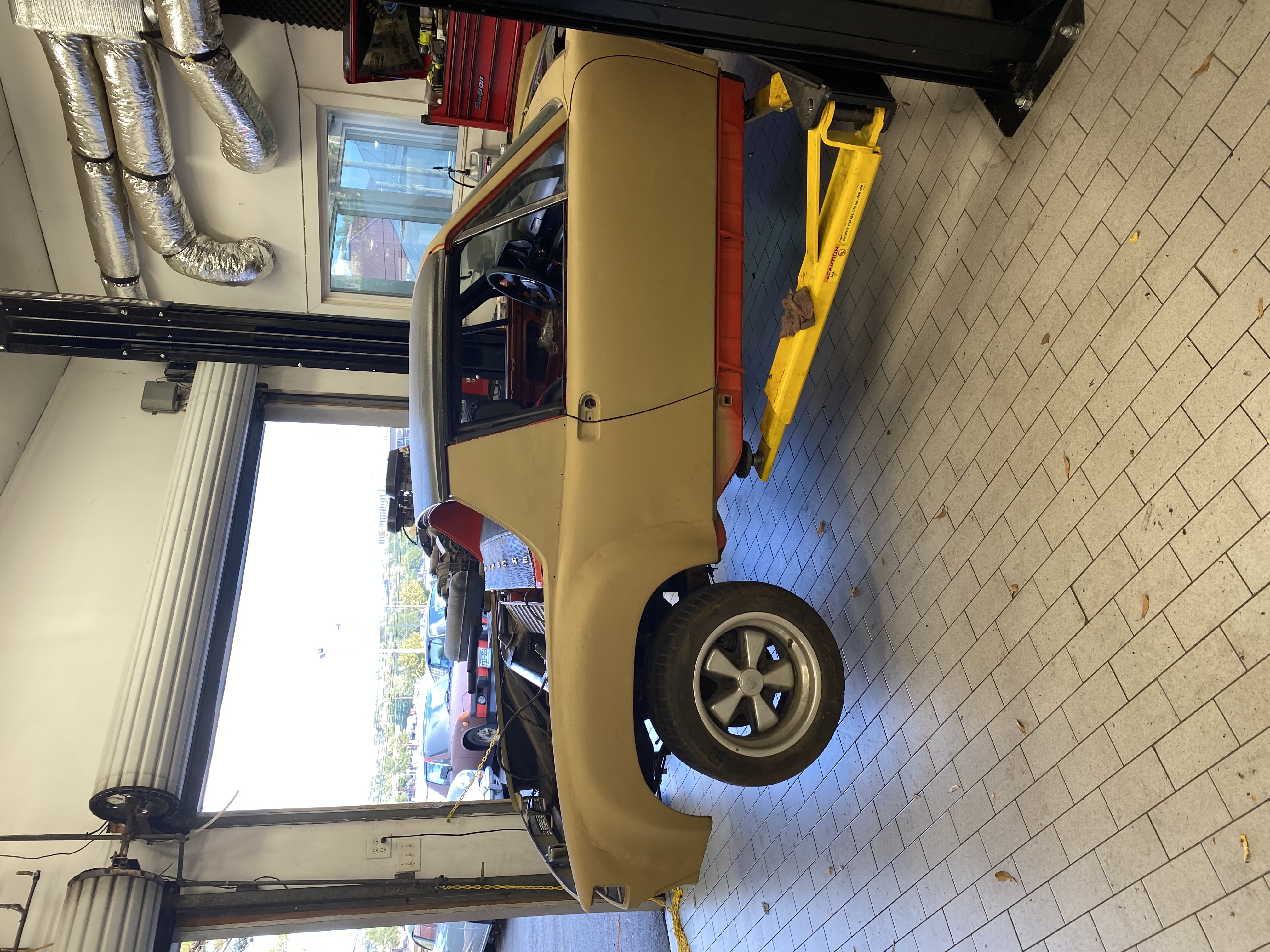

> rear nos quarter panels needed, trying to reconstruct this 914-6 gt
dr914@autoatlanta.com
post Sep 24 2024, 04:26 PM
Posts: 8,232
Joined: 3-January 07
From: atlanta georgia
Member No.: 7,418
We are trying to reconstruct our 914-6 9142430240 and need two new NOS quarter panels, or two spotless used ones if anyone knows of any. We have plenty here but all are not perfect 91450390311 91450390411
post Sep 24 2024, 05:16 PM
Hey nice rack! -Celette
Posts: 21,238
From: Now in Superior WI
Member No.: 43
Other than a 1970's typical weld and beat the panel in to mud the seam, is it rusted?
If that is a real GT-6 and that is a real Porsche flare why not just repair the panel? If all the filler is stripped off in the photo shown, that looks totally repairable to me. (IMG:style_emoticons/default/smash.gif) (IMG:style_emoticons/default/sawzall-smiley.gif) (IMG:style_emoticons/default/welder.gif)
jfs911
post Sep 24 2024, 05:51 PM
Posts: 10
Joined: 10-February 18
From: Toronto,Canada
Member No.: 21,878
Hi
my friend mike, of mikes 914's has an original from Porsche,
but we are up in Toronto Canada so shipping would be a bit expensive.
Give him a call.
