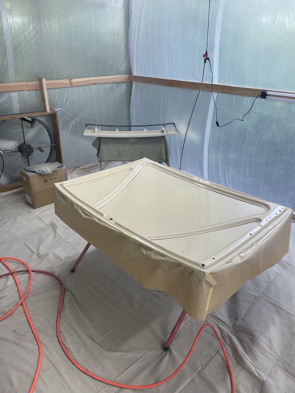

QUOTE(mb911 @ Sep 19 2024, 08:48 AM) *
(IMG:style_emoticons/default/smilie_pokal.gif) This is probably what I'll be using. Might as well... I'm already in the backyard.

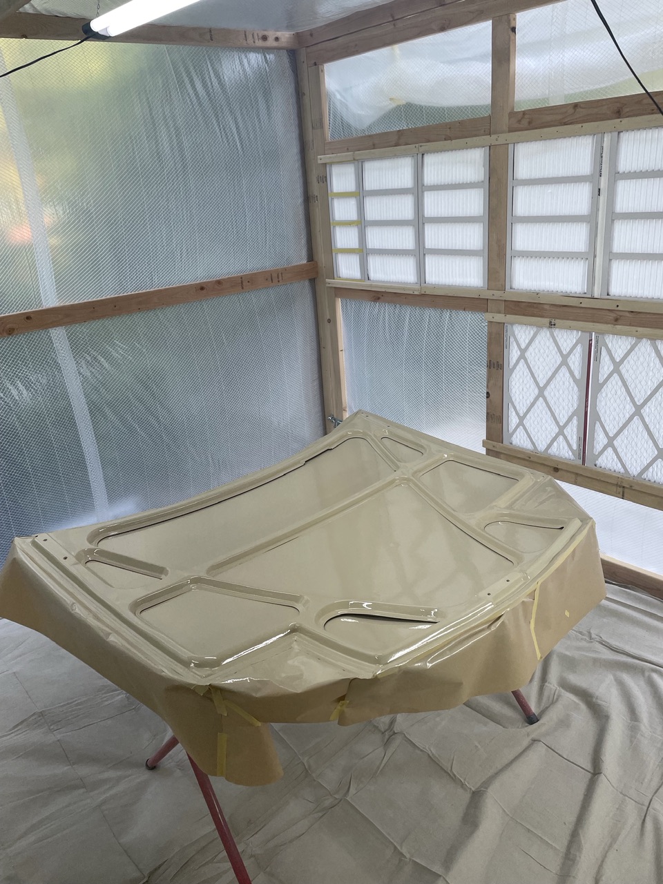

post Sep 19 2024, 09:04 AM
Posts: 1,977
Joined: 28-March 03
From: Millville, NJ
Member No.: 487
I was going to go with an inflatable booth, but in the end I decided to make my own. I enclosed a section of the lean-to on the side of my shop with plastic and put an exhaust fan at one end and a wall of hvac filters at the other. It worked great and ran me about $300.
