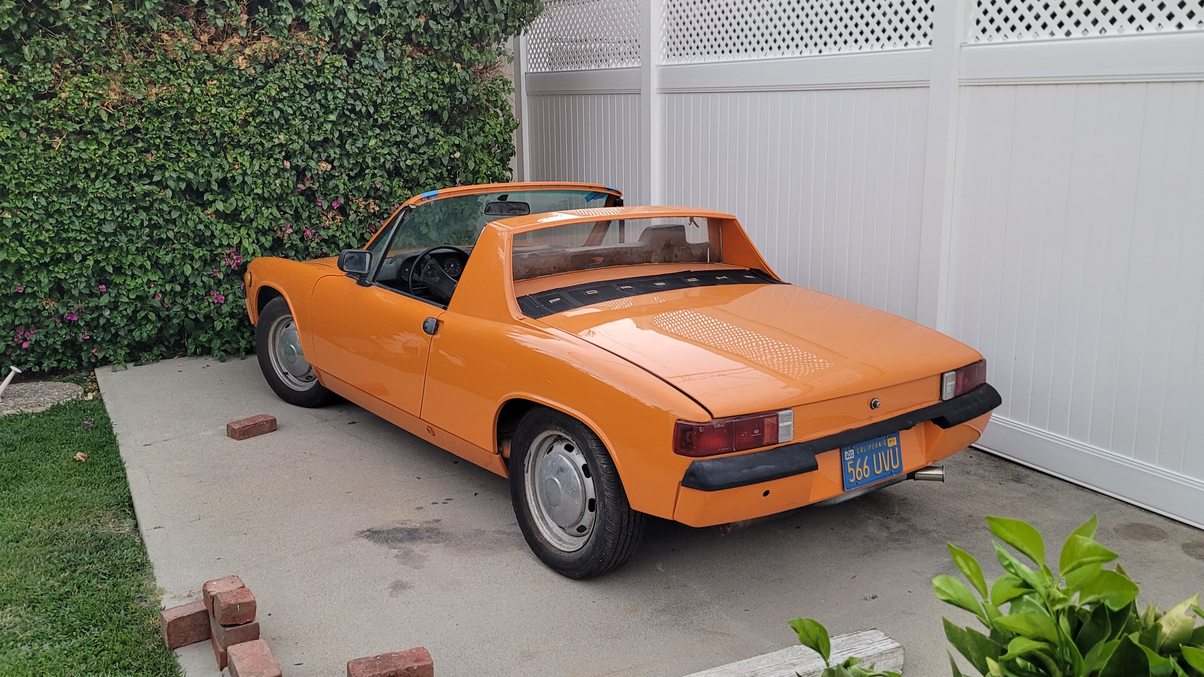

I've come into possession of a 1970 914/4. Unsure of the finer details, but... I've run into a few roadblocks. I figured I should ask here just in case some of these problems are fairly common. If you don't mind my inquiry...

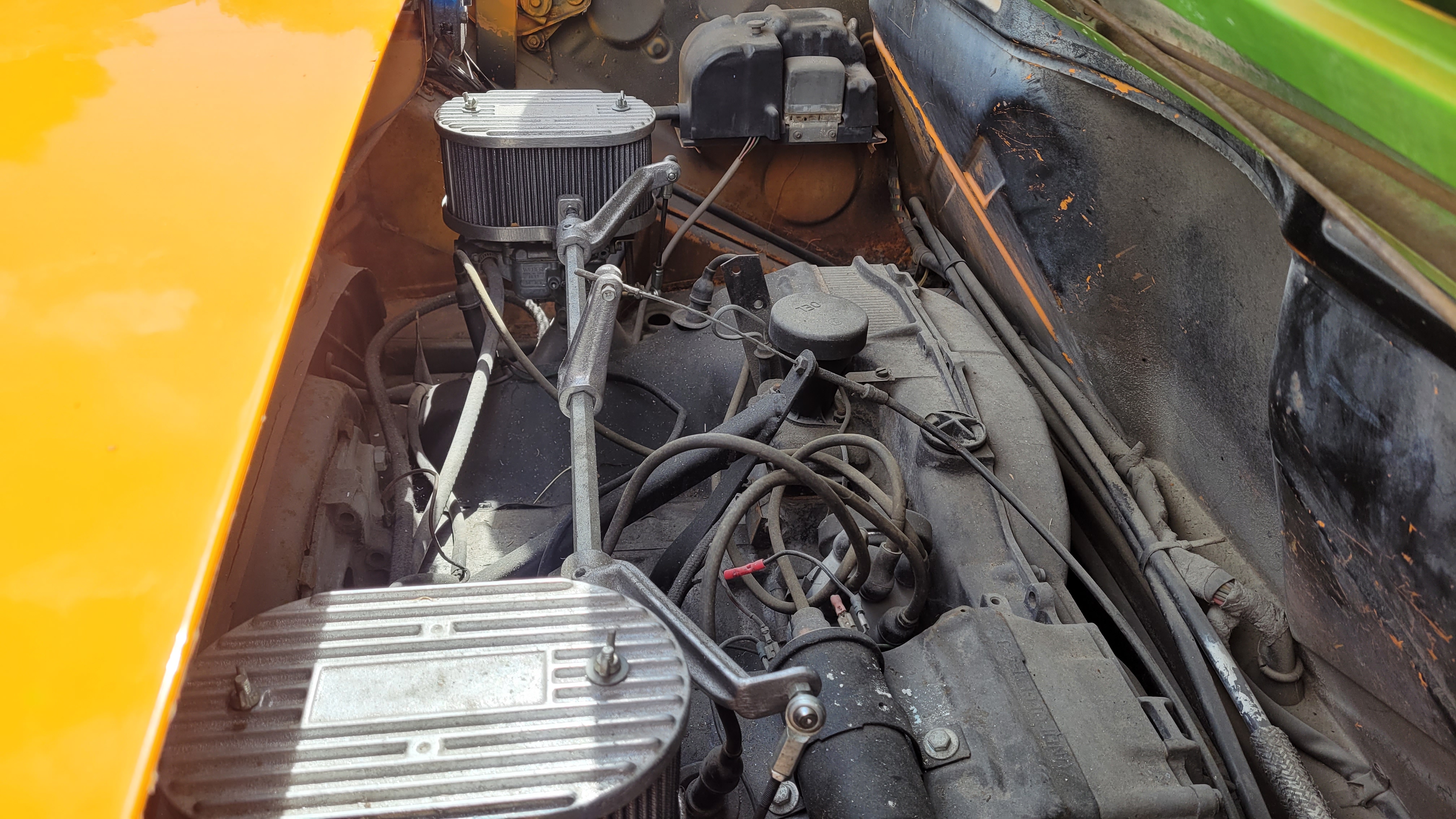

As for the engine this car has... I'm unsure. It has a twin carburetor setup where they stick out high in the engine compartment, but that's all I know.

SirAndy   '70 with non-appearance group trim and steel w...   Sep 16 2024, 02:38 PM

Dave_Darling   Carburetors are not stock. The fuel pump should b...   Sep 16 2024, 03:27 PM
dr914@autoatlanta.com   non appearance group! Pretty rare these days ...   Sep 16 2024, 03:57 PM

PaIsa   From the engine bay picture here are a few thought...   Sep 19 2024, 06:18 AM
Dave_Darling   - You seem to be missing the cooling flap connect...   Jun 19 2025, 11:40 PM
