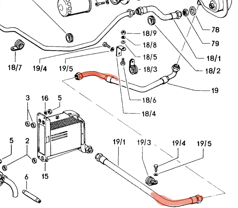

I am having trouble locating replacements for a few of our oil system components. Missing when I got the car. 1970 914-6. Highlighted in yellow and descriptions below. Mostly hardware, and a couple rubber pieces discussed in another thread.
Does anyone have a source new or used? I have searched the usual suspects with regards to Porsche and 914-centric parts vendors. A couple I even ordered from, but then they were unable to deliver.
In lieu of a supplier, perhaps someone has access to these parts that could offer dimensions for the support and tube clamps?
  • 18/3 and 18/7: 999-511-076-02, Clamp for oil hose Pressure line
  • 18/4: 901-107-084-00, Support
  • 19/3: 999-511-077-02, Clamp for intake pipe
  • 19/2: 999-702-089-50, Rubber sleeve for Mount Hose line
  • 78: 901-107-679-10, Sealing ring - lower base of oil tank
  • 18/2: 999-702-132-50, Rubber sleeve Hose line
Thanks.

Dennis
The 'blow-up' illustration confuses locations a bit. And the shape of some hoses/tubes.
I can post pics of most of the parts tomorrow.
I think it will be helpful.

# 78 rubber washer between inner fender and tank
# 18-2 grommit, hose through shelf
# 18-3 Norma hose clamp 18mm supports tube below front engine tin
# 18-4 small 90 degree bracket attached to front engine tin to support oil tube
# 18-7 not sure but may be Norma 18mm clamp to support tube below chain housing
# 19-2 grommit on hook on body
# 19-3 30mm Norma clamp that attaches to heat exchanger to protect hose from hot
exhaust

Oil plumbing supports

attachment point on engine tin

Thank you for taking time to share this. The photos help a lot with context and positioning. The Norma markings on the clamps will help me track those down. I assume the number matches the OD in mm of the pipe it is clamping.

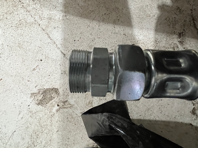

A follow up on this in case anyone else goes down this rabbit hole. I think there is a male-to-male connector needed that isn't listed in the parts catalog.
For the hoses I bought, 19 and 19/1 both have female connectors. You need a male-to-male 30mm union like seen in the photo. Luckily it came with the 3-piece hose set I bought from Patrick Motorsports.
