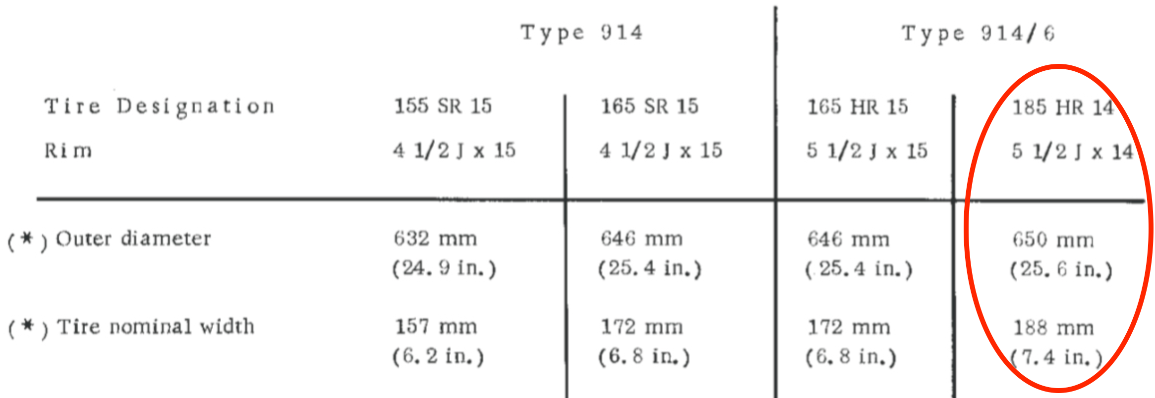

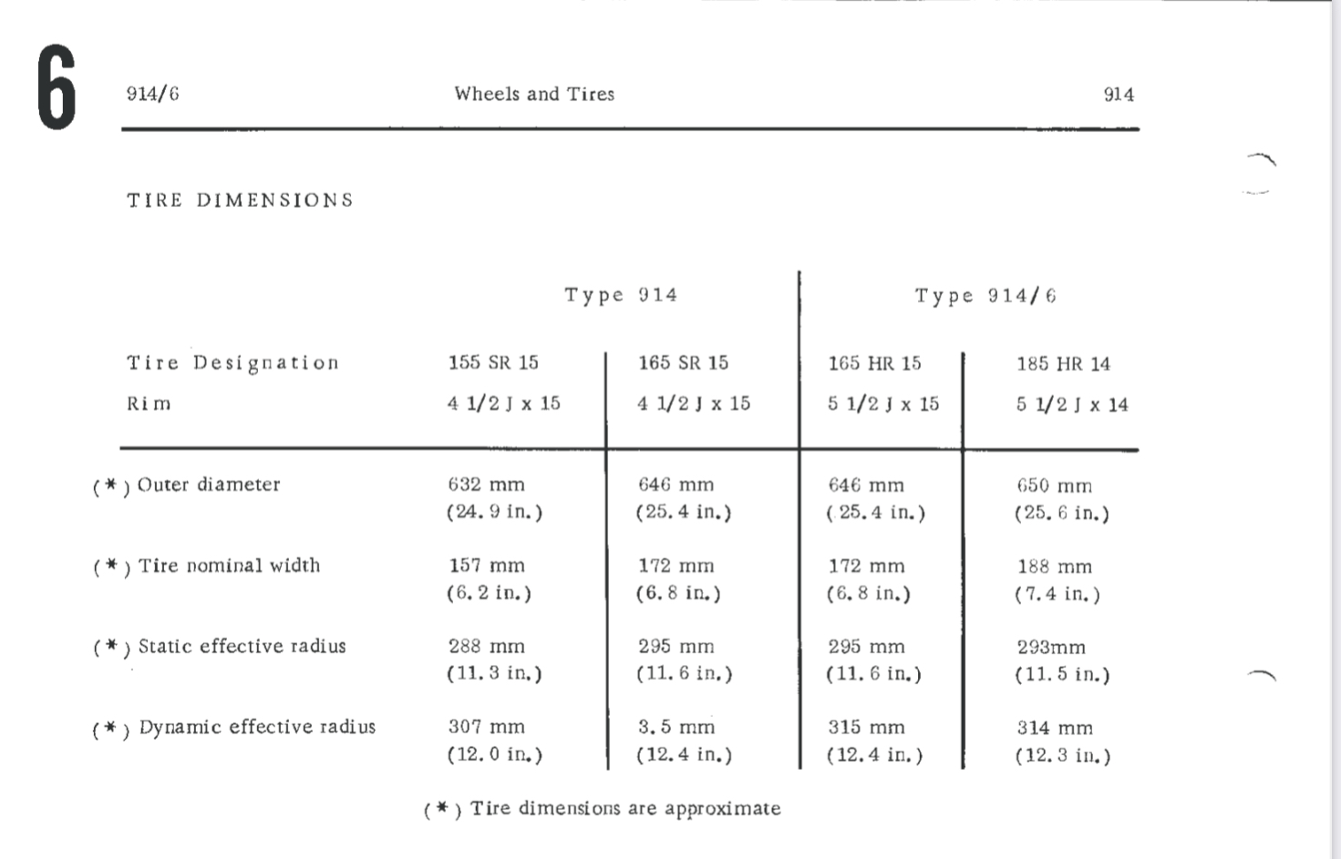

If speedometer accuracy is a concern at all then you need to compare the tread diameter. This page from the service manual neglects the 15” alloy rim that also was optional, that ran 185/70 15 tires with a diameter of 25.2.

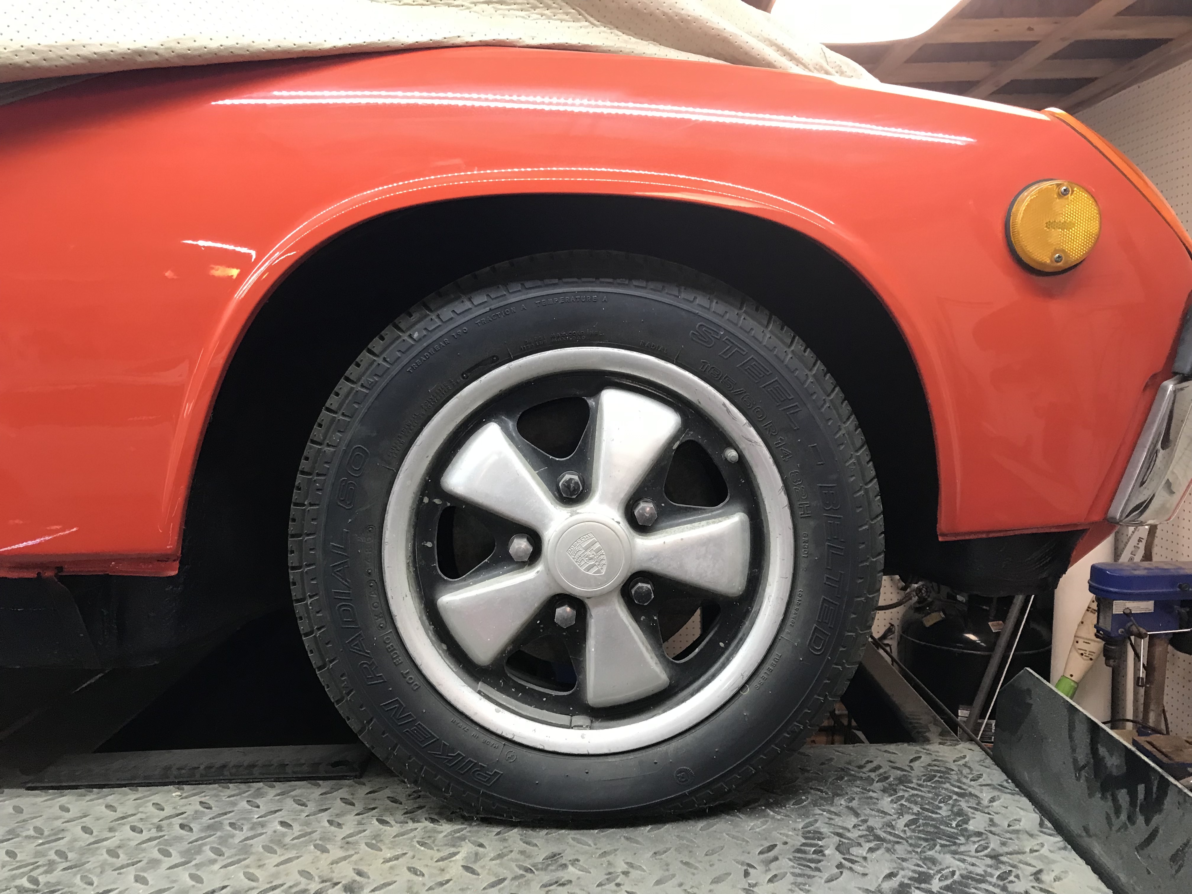

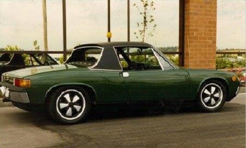

I have Riken 185-60-14’s on my car.
Don’t know if they still make them..
Used them on an early 911 mostly.
This tire is under inflated and the ride height
is wrong so this may not be a good picture to compare..??

QUOTE(gandalf_025 @ Jun 4 2023, 02:13 PM) *
Very helpful. The framing in the wheel well is noticeable different to me. Not bad. Just different. Thank you!
Thank you for pointing that out. I had overlooked this table. The Coker website will let you filter on radial width among other things.

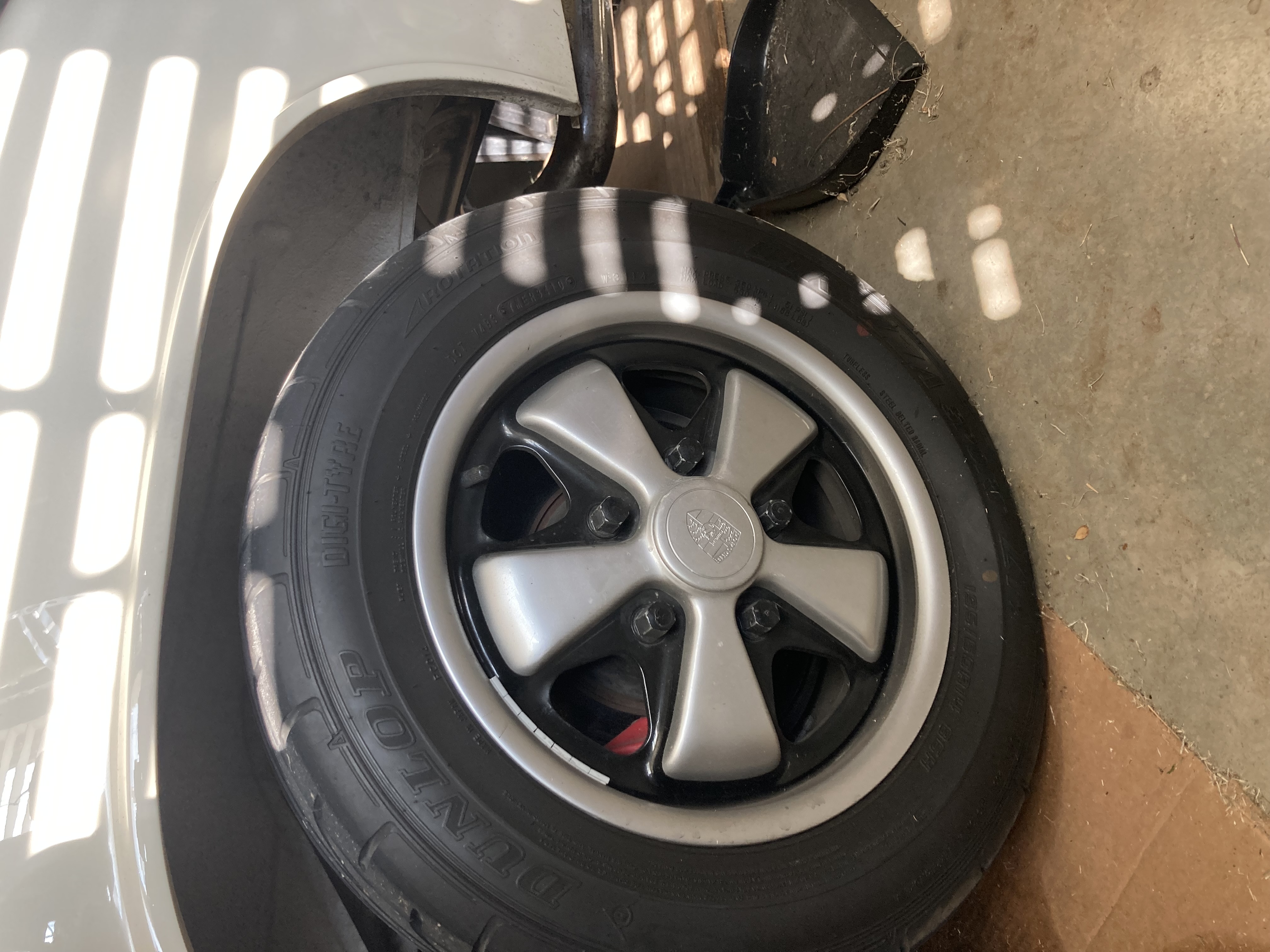

These are Dunlop 195/60

Maybe it was obvious to others, but I was fishing for the aspect ratio of the side wall for the original tires. Thanks to the table from @zoomCat and a tire size calculator factoring in the wheel size, I think the closest modern day equivalent is:
185/80R14.
This lands you at: Tire Height: 25.66'' (652 mm)
Anyone got that combo they can share a photo of? It is about 1/2" difference in sidewall height from what we have now.

Correct. Back then they didn't put an aspect ratio and as others have mentioned, its close to an 80 series tire.

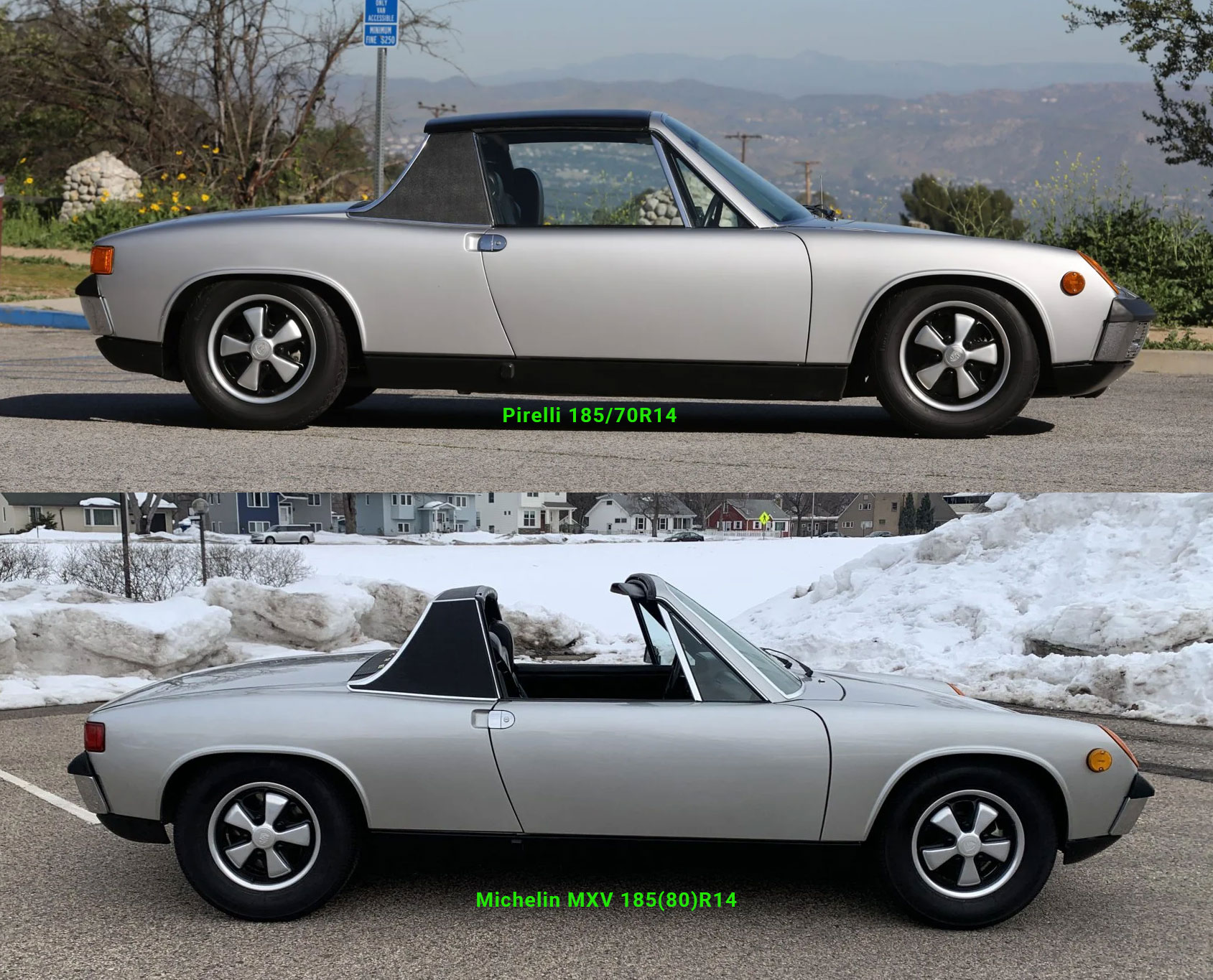

A couple of recent BAT auctions served up a direct comparison on nearly identical cars. (IMG:style_emoticons/default/piratenanner.gif)
