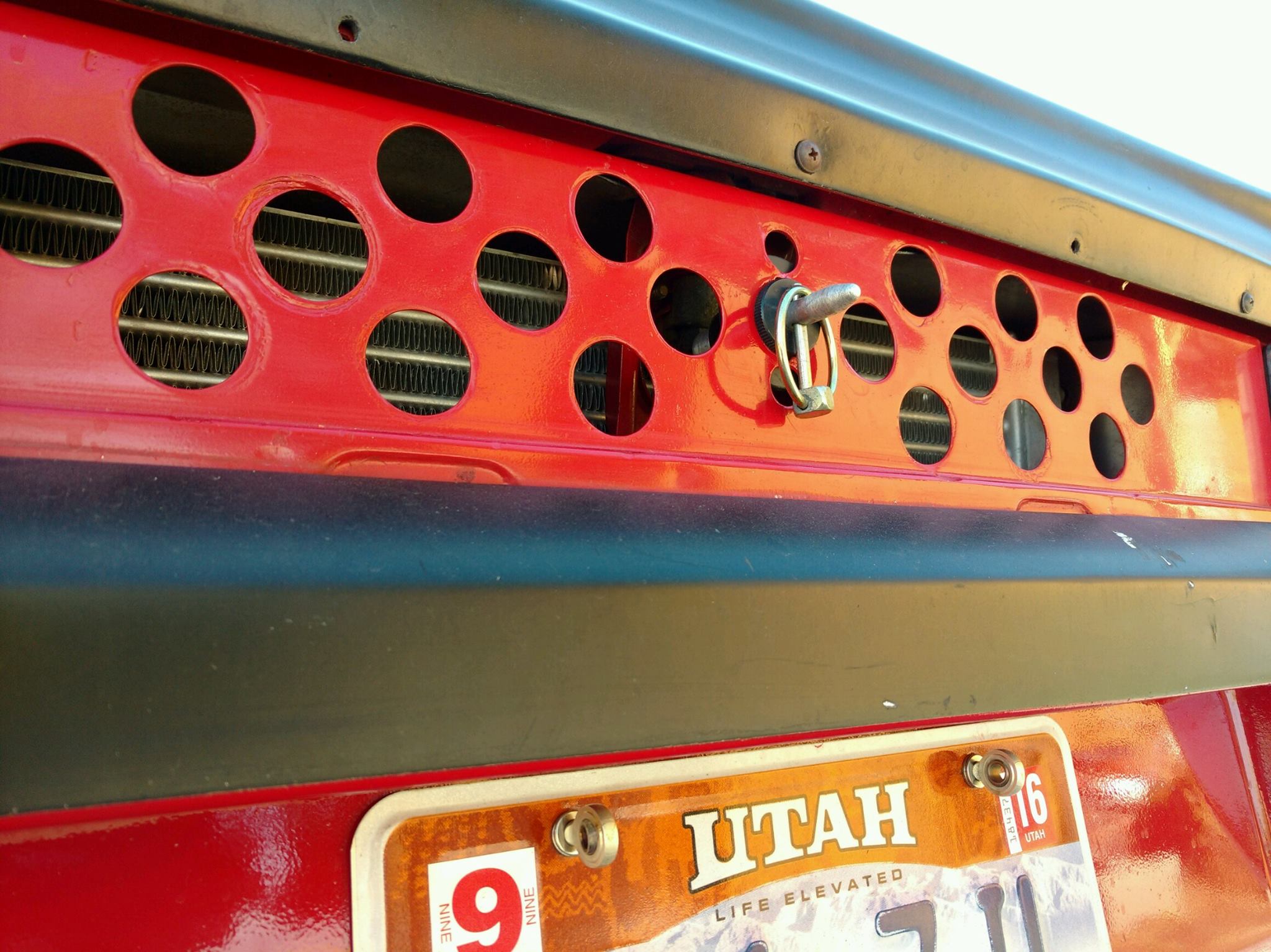

Hi folks - just doing some planning here for 3.2L build and it looks like most of the front oil cooler installations end up cutting the factory bracing extends from either side of the car near the headlights to under the front latch.
The Patrick Motorsports kit from the shapes in the kit seem to presume that but I wanted to ask what most people end up doing. Some recent big$ sales on BAT took the cut/remove approach but I’m a bit reluctant to dive in with the cutting disks.
Example picture attached
Thanks!

So you have a 73 or 74 which has the added reinforcement?
Maybe the shroud fits underneath it?
That car is likely a 70-72 and nothing was modded, just cuts for air holes.

Early cars didn't have the cross brace.

Ah, didn’t know that the early cars didn’t. Thanks Chris. It is a 1974 car.

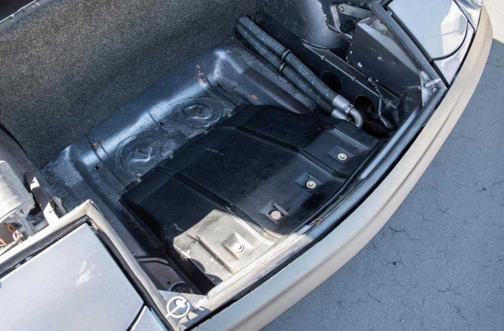

This is how I did mine. Remember I have an rsr sized cooler in mineAttached Image

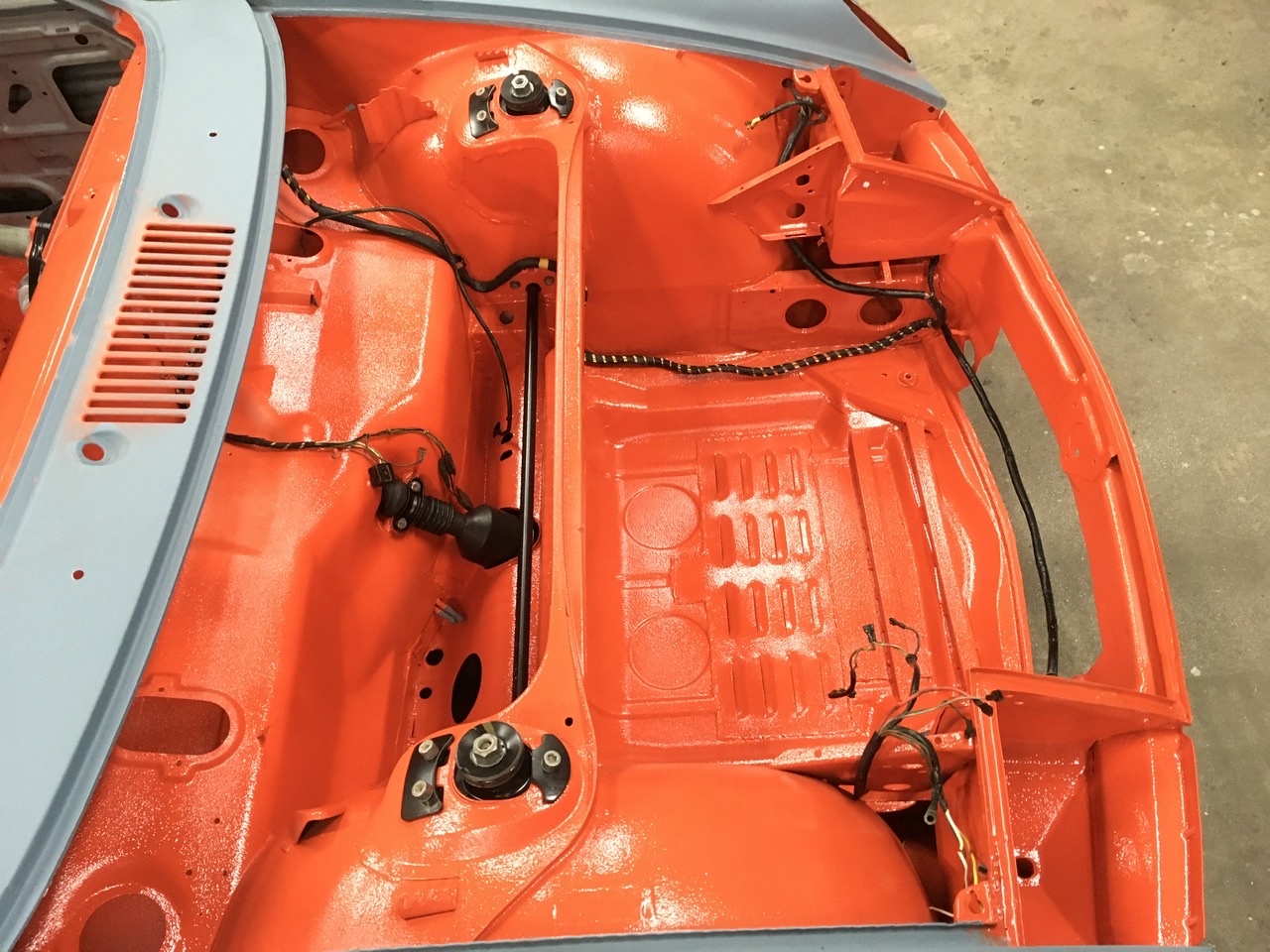

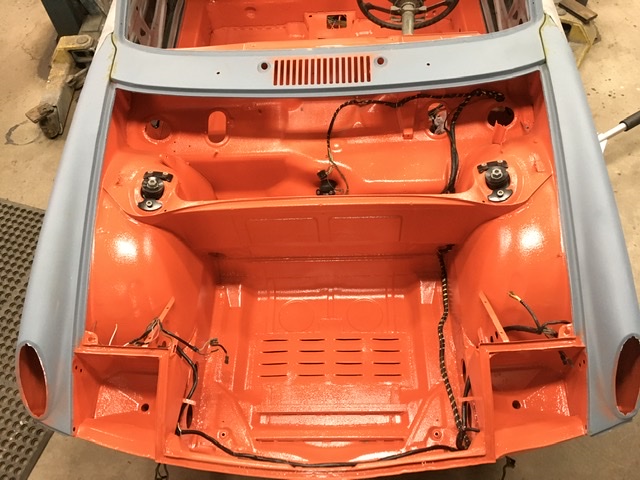

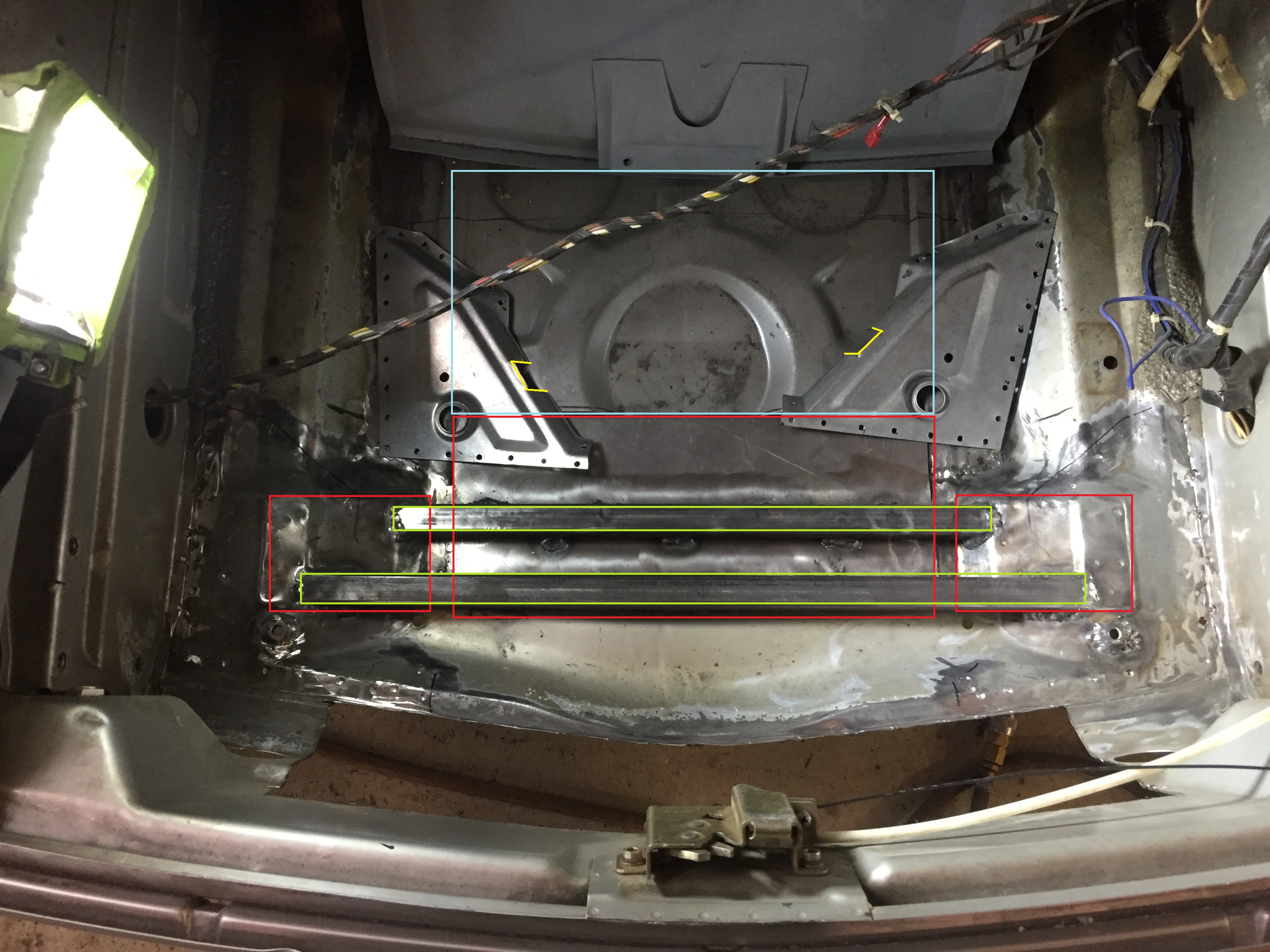

I had the area reinforced pretty close to AJ's formula, but somewhat simpler (cheaper). We took advantage of the restoration design corner reinforcement pieces (that are now available) and notched them rather than the elaborate sectioning and piecing that AJ did.
This also allowed us to have the crossbars land on thicker reinforced pads that spread the load into the sheet metal.
In the diagram the red rectangles are 4 mm sheet steel the smaller ones are contour bent to match - the larger one is just flat. The green rectangles represent the 1" x 1" x 1/8" wall steel cross members.
The yellow lines show where the RD stamped corner parts were notched.
This was all done by Chris at Tangerine Racing.
The blue rectangle is the exhaust air cut-out (shown 2 pic below).
The last pic shows the flow cap, prior to welding (this part is available at Mittlemotor)

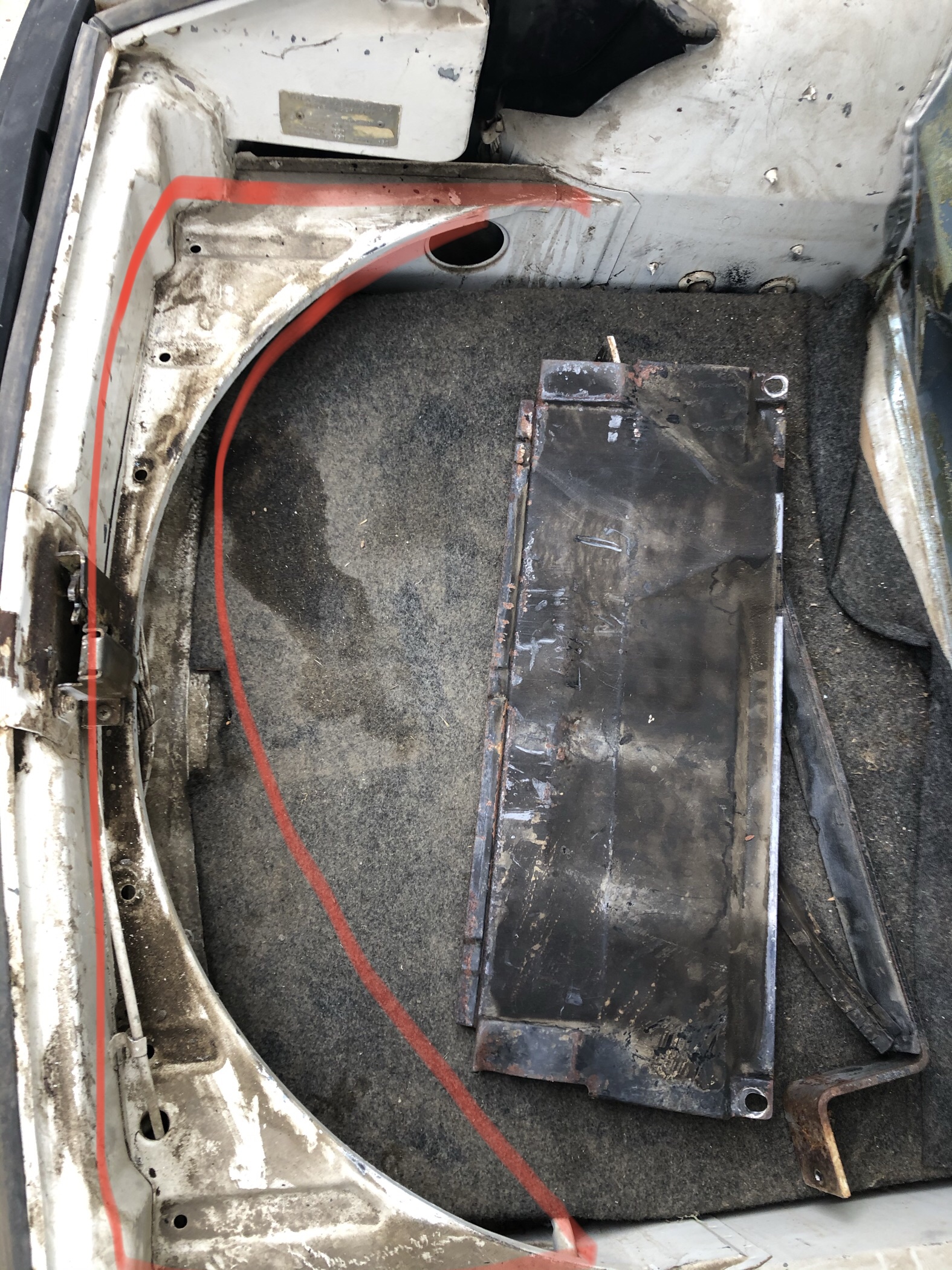

Just to be clear, I’m asking about this in red.

QUOTE(Tdskip @ May 16 2021, 07:51 PM) *
I say save it. Half circle shape adds strength.

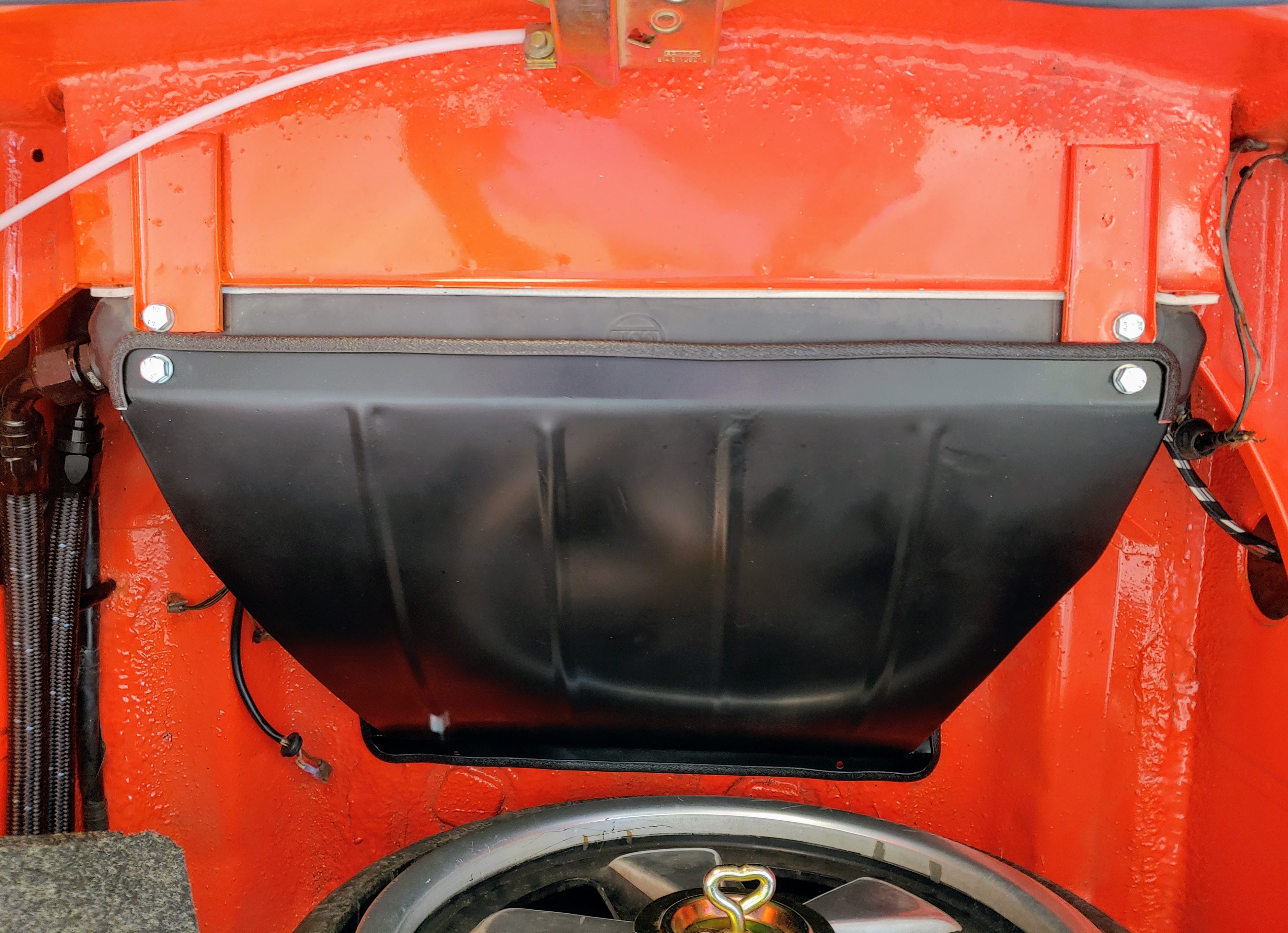

AFAIK the PMS cooler fits under there.
